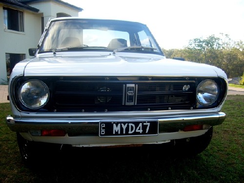

wheels are 15x6 chasers off a kia cerato. you can't really see in the pics but offset has been taken in 15mm at the back for a wider (legal) track and a deeper dish. front have only been taken in 3mm to keep it legal and clear the strut. 195/50 tyres rear, 175/55 front.
they were already black i just polished them with kitten.
probably right about the headlights - maybe down the track.

Hey Randoli that looks awsome , makes it look like a different ute
really finishes it of now specially with the black wheels
are they just chasers painted black?
i think some crystal headlights would look good
P.S i love that jap spec ute , its one sexy ute

finished it during the week. what do you all think?
i have to say i started with the steel wool - 7mins my ass!!!. the bulk came off reasonably quickly but getting into the corners etc was murder. the finish under whilst black was not great. taking it back was all good in the end and provided for a good base. plastic primer (2 coats), gloss black (2 coats).
