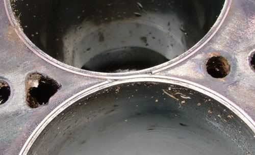

bore flex comes to mind along with a tad of blowby
Posted on: 2009/12/6 23:56
Re: Big valves and odd rods
2003/6/27 14:53
Posts: 8287
Bless me soul, at 80mm with an offset, one side of the bore must be so thin that it would almost be transparent. LOL
Posted on: 2009/12/6 23:35

FYI Dodgeman, BigE on here has an offset bored A14 with 80mm bores..
and yes I have followed your lead and on the Path of Big cube A12A goodness.. :)

nice, i take it the meat taken from next to the crankpin is for balancing? i think i'm still going to do it, but maybe not such a big bore. am thinking of using unknown pistons if i can't trick up the A15 ones. I'll run big clearances on the pistons with light rings, this engine is purely for the 1/4 mile by the way, hopefully the pistons won't grab, next issue will be headgasket i guess, thinking of going steel.
O-ring job at 79mm bore? don't really follow that one.
may as well go the whole hog and stuff the block with grout! i wonder if running coolant through the head but not the block would cause issues.

Yes, offset boring of the cylinders is good with the 79mm bore but at 80mm I think you are pushing your luck just a little bit too far as I do not know of anyone who actually did it & made the engine actually run.
Generally speaking, a 3mm overbore is the practical limit, however I have a 1200 engine at 76.5mm & it ran fine for years. I have also seen a 1200 engine at 77mm & it too was running fine but those cylinder walls had to be getting awfully thin.
The problem with the A15 crank is that it will pull the pistons into the rotating mass of the crank at BDC.
Even with the A14 crank you will need to machine the counterweights to clear the pistons & you need to machine about a half mm from the top of the A15 pistons to bring them level with the top of the block.
'O' Ring job at 79mm
A14 crank mods.
Posted on: 2009/12/1 12:52

so much great info, thanks Dodgeman, is the A15 crank longer or larger diameter? if its larger diameter i think ill try make it fit anyway. as for why use A15 pistons, well i wasnt actually going to use A15 pistons but i didnt want to jump ahead of myself as i wasnt sure how large i could bore the A12. I'm going to try and get an 80mm bore.
Has anyone had any success in offset boring the cylinders?
