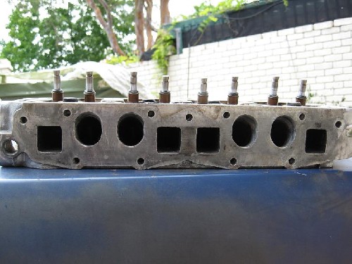

H75 head slightly ported to match GX manfold (NZ GX).

H75 heads have open chambers ports are of the low variety I think
don't look as open as the pics above
check my build thread for some average pics of a h75
