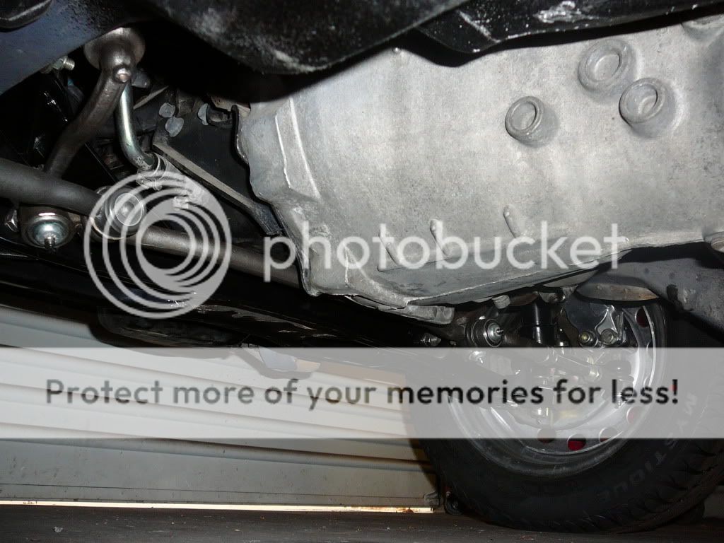

il tell ya now damian... it will fit, its under my ute buddy
