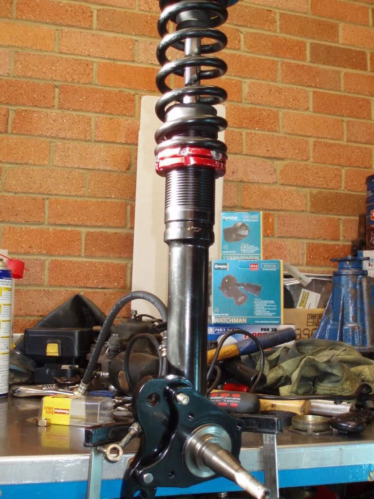

Ok that pics helped (thanks Benny and Ange)..looks like I should be welding a bracket to my strut and utilising the S13 hose from caliper to the bracket. I was feeling like just having one long hose dangling there was a bit wrong!
Hope I can tack something on without having to pull the struts out.

i welded a clamp (from my 1200 struts) to the 120y strut to support the hose as it sweeps to the front
mine are plenty long, perhaps there is more than one type of hose for s13?
an old pic
Posted on: 2011/5/21 10:12
