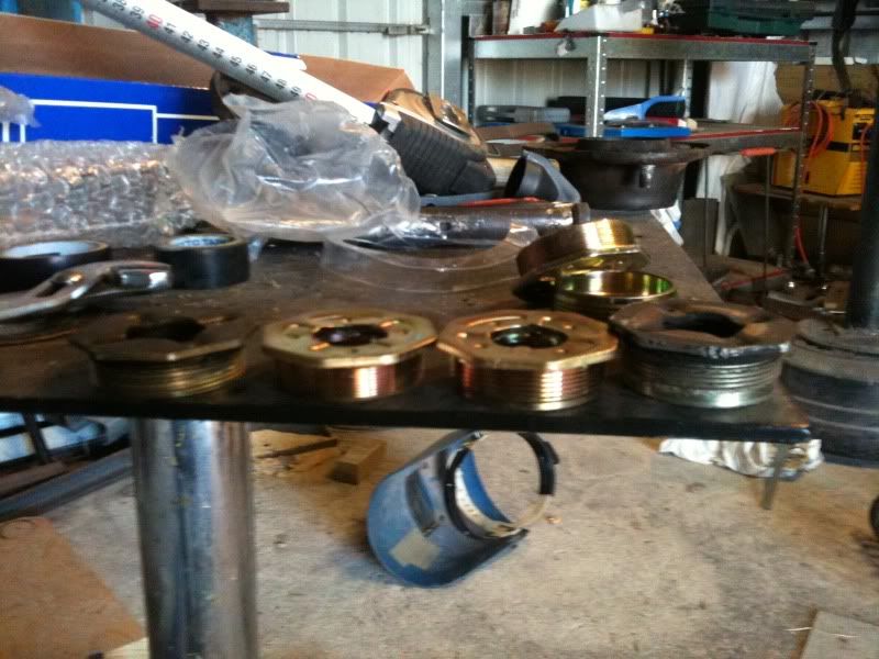

http://i113.photobucket.com/albums/n2 ... OT%20related/IMG_1532.jpg
The one on the left is stanza, one on right is R31, middle two came with inserts

Posted in my stanza strut thread:
"I just finished putting R31 inserts into sectioned stanza struts. I can confirm that all the different R31 gland nuts (holds insert in) did not fit the stanza tubes. I had a nut from my R31 struts, a fine thread nut and a large thread nut that came with the new shocks and all were too big. I used the stanza ones I had but thought it was interesting that they were all different."

sYeah but the R31 insert is larger diameter as well. I'll need to die grind the gland nut out about 1-2mm to accomodate the bigger insert. Shouldn't be too hard. Wish I got the Camry inserts now!!

In regards to the gland nuts, the Stanza strut nut is 1mm smaller than the R31. It's not much but definately not compatible, I even tried screwing it in again to make sure I wasn't on drugs! Even though the outer tube is the same they must just machine out the Stanza a mm smaller.
