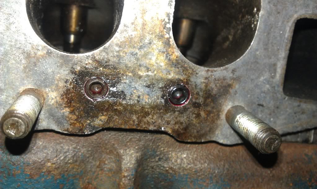

Re: H89 water gallery pluging?
2009/6/7 14:09
From Gawler, Sth Aust
Posts: 153
Grub screws are in and cold tested. In the end I went for M8 (due to availability) and sealed with Loctite sealent.
http://i1212.photobucket.com/albums/cc444/tstorm1986/IMAG0150.jpg
Thanks for the help guys.
Posted on: 2011/9/13 14:11

from memory 4mm (mabee 5mm) tap and screw some plugs in there, i just got bolts cut off the heads slotted them and screwed them in.. with a bit of loctite pipe sealenat on them of course..

Thanks guys this stuff really helped, ill have to hit the stores and track down some grub screws of a similiar size. knowing that its a process nissan suggests gives me piece of mind. I was worried about opening the hole a bit and cutting into something i shouldnt.
