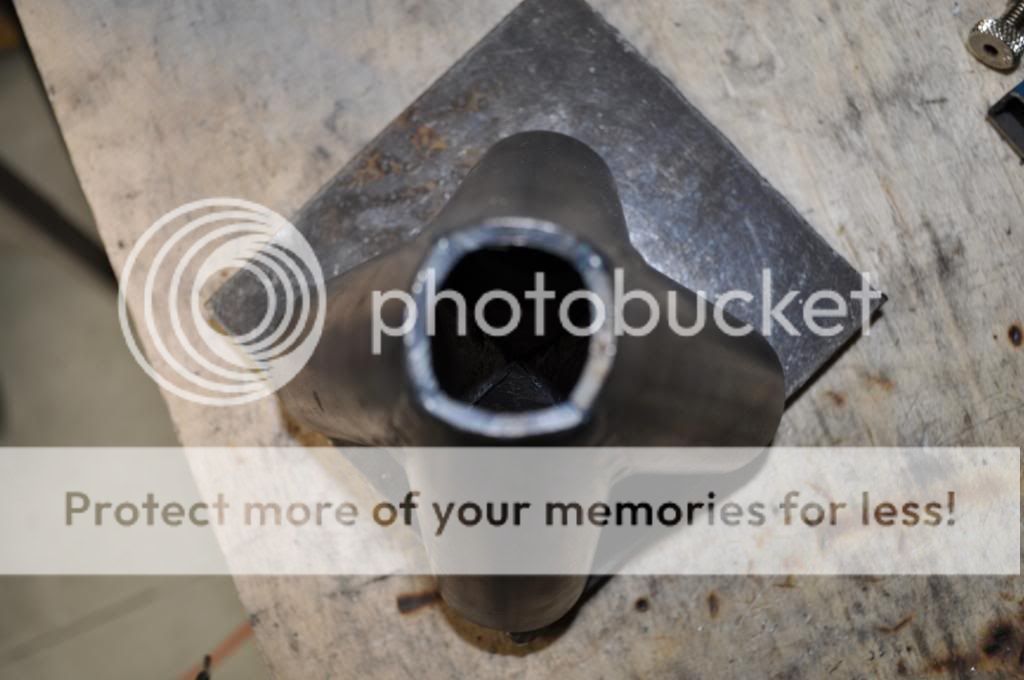

some picks of merge collector

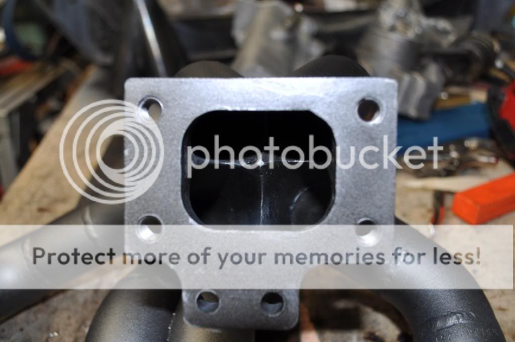

its a proper laser cut merge collector will take a photo down the outlet tomorrow.

anyway EX manifold is fully TIG welded, all arms were welded off the manifold too minimise stress on joints, all tacked up,then welded onto merge collector, then removed from head flange, arms made even(flat)then welded(bolted tight to head)to flange. has been painted with heat paint.
the 2 bolt holes were on the T25flange, you could run a brace off it but i think i could stand on it (steam pipe is strong).
