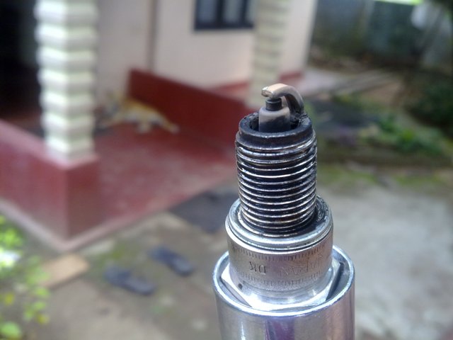

Re: Make It More Fuel Efficency ?
The light brown color indicates very good burning.
Problem seems to be solved. Good work!

Hi Guys
Since last few days were holidays i was unable to buy stock size jets, But i had 75 and 100 and installed them for the time being , Lubricated the power valve plunger and washed with fuel and hopefully it will work for sometime, and cleaned all the jets and installed the carb and started it got started on first attempt and tuned the engine as good as i can ?
i drove it about 20 Km no problem at all and removed the spark plugs and checked ,
What do you guys and recommend me by looking at these spark plugs ? for me they are light brown color
thanks
regards
sumith
