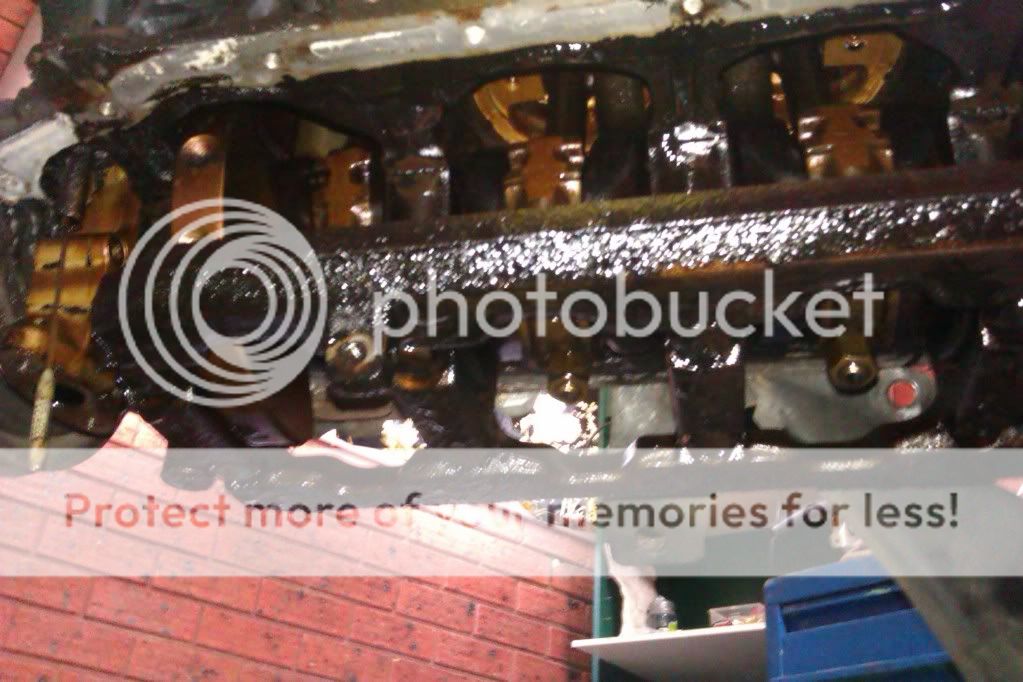

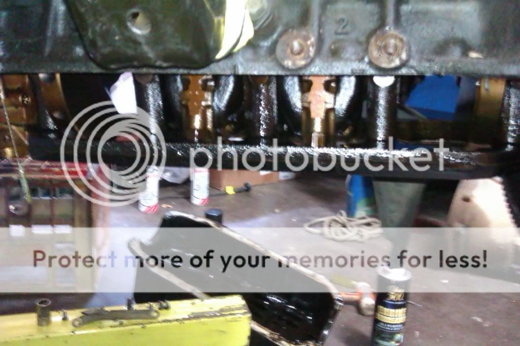

Re: CA18DE+T how to tune one
2002/10/28 6:49
Posts: 10926
From what Ive seen the FWD exa dont have them,
but all rwd ca18de/det have them. The sump on
the exa is also like halve a winged sump.
2004/10/28 11:35
From Geelong, Vic
Posts: 6184
yeah its only the really early CAs that didnt have the girdle apparently, ive never seen a CA without it....the DE is pretty much identical to a DET apart from the pistons and oil squirters and different water outlets in the block accessories
2002/3/20 3:40
From Melbourne, Australia
Posts: 8221
was swaping the sump over and found the DE has a cradle type structure in it, is that normal?
Posted on: 2013/1/20 3:42
