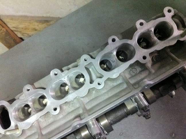

yea dattodude is right ,i did that on my a15 when i ported it ,just sit the gasket over the studs on the head then dremel the inside out to suit, easy ,cheap and wont leak like a home made gasket will

Just buy a standard paper gasket, trim it to suit, and correctly torque everything.

I'd still use a standard one and just trim it back, atleast the bolt holes and the outside edges are already the right shape.

Hi clyons im getting work done to the head,so the standard one wont be any good.Im getting the 8 port converted into 4 larger ports,like this.
