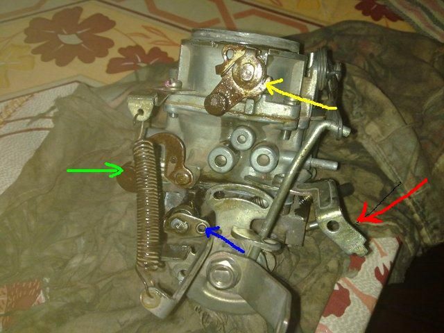

Hi DD
then i need to find a bracket to hold choke cable
thanks
regards
sumith

Re: Few Carburator Questions
The red-marked bracket is for Throttle Cable:
I think it matches this bracket:
The choke cable bracket bolts to the top of the carburetor.
Posted on: 2013/3/14 7:02
2008/11/26 10:52
From Sri Lanka
Posts: 1232
Hi L18_B110
thanks a lot , then (pink color) part could be halfway link to the choke connector ,which is missing another linkage from the middle just smiler to the throttle linage,
Then it was running with few parts missing so far
thanks
regards
sumith
Posted on: 2013/3/14 6:59
Exactly right.
Compare to the Type B choke cable bracket:
Similar to this bracket marked in red:
Posted on: 2013/3/14 6:57
2002/8/6 2:24
From Brisbane, Australia
Posts: 3792
yep, the yellow arrow points to the choke lever. But you are missing the bracket that holds the outer choke cable. You're also missing a linkage from that choke lever to the throttle lever.
Green arrow points to the counterweight on the vacuum secondary.
Blue arrow points to the lever that operates the secondary throttle. You're missing the linkage that goes in that hole at the end of the lever.
I can't really tell what the pink arrow is actually pointing to.
2008/11/26 10:52
From Sri Lanka
Posts: 1232
Hi Guys
I have this type manual choke carburetor in my b210 , please clarify me what are these arrows things for ?
Yellow one is the Choke Cable connector Is it ?
i have never seen how is the choke cable hooked since i don't have one in mine ,can any body please post a picture of a choke cable ?
thanks
regards
sumith
