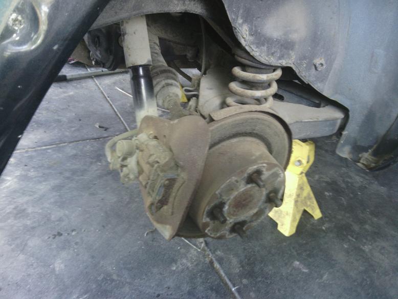

Re: Rear disc brake ID???
From these, and maybe others:
43206-P6500 ROTOR, REAR 268mm
* USA 280ZX 1979-1981
* USA 910 L24E, LD28 1981
* JAP 910 Bluebird SSS
* JAP C31 Laurel [some]
Posted on: 2013/5/6 21:05
2008/8/24 13:11
Posts: 194
rotors are 268 mm
Posted on: 2013/5/6 13:25
If they are 258 mm rotors, they come from:
JAPAN
* 910 Bluebird 8201-8907 Z18E,Z20S.SSS,CA18E
* C31 Laurel 8111- GX#+K.L20.MD
* F30 Leopard 8107-8301 L20E#
* R30 Skyline 8108- FJ20E+L20ET
* S110 Silvia 8105- Z18ET+Z20E+FJ20
* U12 Bluebird 8709- 4WD + CA18DET,SR20DET
* S12 Silvia 8308-
* Z31 Fairlady 8309-8610
USA
* 1982-1983 S130 280ZX 0981-
* 1984-1986 S12 200SX 0184-0686 CA18ET, 1184-0686 CA20E
* 1982 S110 200SX 0781- Z22E
* 1982-1984 910 Maxima 0981- LD28.MT.F5 +S.LD28.AT +S.L24E
Not all 280ZX use the same rotors. 280ZX rear rotors came in 258, 268, or 290 mm sizes.
2002/8/11 8:22
From Perth
Posts: 2691
280ZX
Posted on: 2013/5/5 4:13
2005/8/27 15:36
From Townsville, Qld
Posts: 2964
If you measure them it would be a start to check through the dba catalogue
Posted on: 2013/5/5 3:52
2008/1/20 11:52
From Perth WA AUS
Posts: 9631
These brakes have been fitted to a C10 Skyline just trying to find out what they are off.
Cheers.
