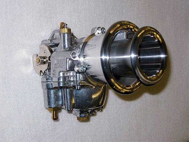

Here is another option not as oldskool but still sort of period and cheaper than buying/rebuilding a 2 inch SU these days.
jpg  z+maxflow_twinstack+velocity_stack.jpg (74.47 KB)

The SU is only temporary there is a way to go from 50.1mm to 56mm with this unit but I remember something along the lines of 48-50mm will allow enough to flow up to 180-200hp yet I only expect to make 60% of that. I really wanted to take steps by running it in and going in stages but more importantly getting started on the most important part the block.

Another issue I'd mention is carb size. In the past you've often (that I can recall, I don't stalk you so I don't read every post!) suggested a 1 3/4" SU as being adequate for a drawthrough, but here you are considering a >2" SU for an NA engine. Here's teh thing, yes the turbo can force feed air/fuel into the engine well above it's ability to draw it in normally aspirated. BUT in a drawthrough, even though the turbo compressor wheel can create a massive pressure drop behind the carby, it is still up to atmospheric pressure to push the air in through the carb. So in a drawthrough, much like an NA engine, you'll actually find that the size of carb that can supply X bhp for an NA engine of some type is about the size you want to attain X bhp for a drawthrough turbo. SO if an NA 1800cc engine will 'like' a big SU, it should become fairly obvious that even a modest boost drawthrough a15 will too. Since that turbo can produce a larger and constant pressure drop behind the carb, it WILL still make good power with a 1 3/4 SU, so for a streeter it's not a huge concern really, but for something more serious it's fairly easy to make a good case for either a 2inch SU or perhaps twin 1 3/4" SUs for a drawthrough. Knowing from experience (and I bashed my head against brick walls for a long time with this sort of stuff back in the late 80s and early 90s when it was impossible to get any exhaust shop to put a 3 inch exhaust on a turbo 6 for example) anyhoo, it became clear that for around 200bhp twin 1 3/4" SUs on a drawthrough wasn't a bad option. You'd 'get' it with a single, but there'd be so much more back pressure as the turbo has to work that much harder to manage to get sufficient air in through that carb to produce the same boost levels (and create more heat in the process, putting one closer to detonation)
