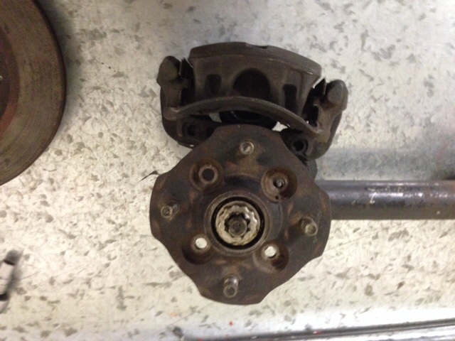

After having confirmation from another respected forum member, It turns out it was the brake adaptors from Datgx that caused the problems, if you have the chance to buy them be wary.

Looks like the holes in the adaptor plates don't seem to be in alignment I.e. The radius dimension differs where the calliper lug mounts attach. Something not quite right there..

Turns out I have the same issue with the 120y struts as well. I will try different calipers I think. The photos are of the adaptor mounted in both directions.
