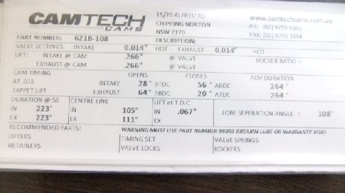

Cost 270 aus for the cam regrind. 88 aus for follower refacing, 110 for springs.
As for what power it will make, i'm not sure... this is my first engine tuning project.....hoping you guys might be able to give me a few pointers...
For the price of parts etc it would make more sense for me to buy a 2nd hand newer type engine, but i like these little engines and it looks right in my engine bay..

Thaifrog whats that worth?

i have a similar project, A16, slightly worked head, extractors and WEBER 32/36 or maybe EFI
I'm looking for something not too hairy and was advised by Camtech cams to go with their 621B.
I received it just today.. here is the spec label which came with it.
They resurfaced my followers and supplied a new set of double springs also.
jpg  DSCF9290.JPG (97.60 KB)
