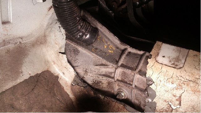

So when people say "Slight massage" it means this....
jpg  1.jpg (110.05 KB)
16973_540825e9e5e48.jpg 601X339 px
jpg  2.jpg (113.55 KB)
16973_540826000eb23.jpg 641X361 px

Got the tunnel to move about half of what I need using hammers.
Got the grinder out to cut L sections.
Hammered some more and its almost an r30 home.
Had a good look at the shaft on the r30 today. Looks a little different to the 4 speed that was attached to the L20b. The shaft that extends from the spline is shorter.
Any ideas?
