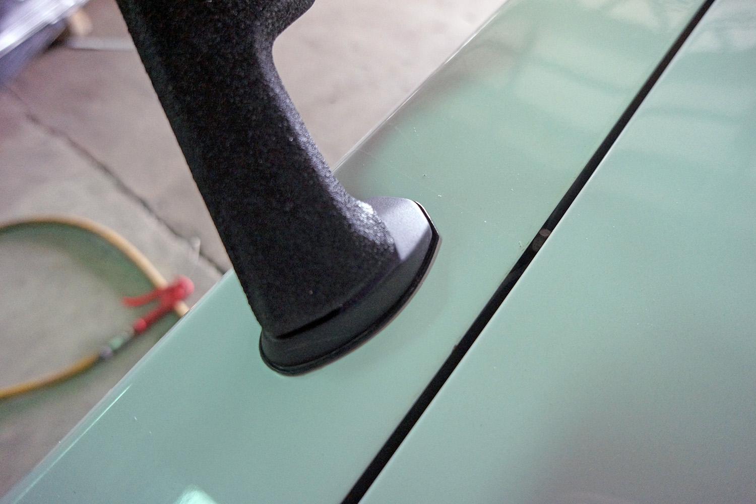

Hi Nick,

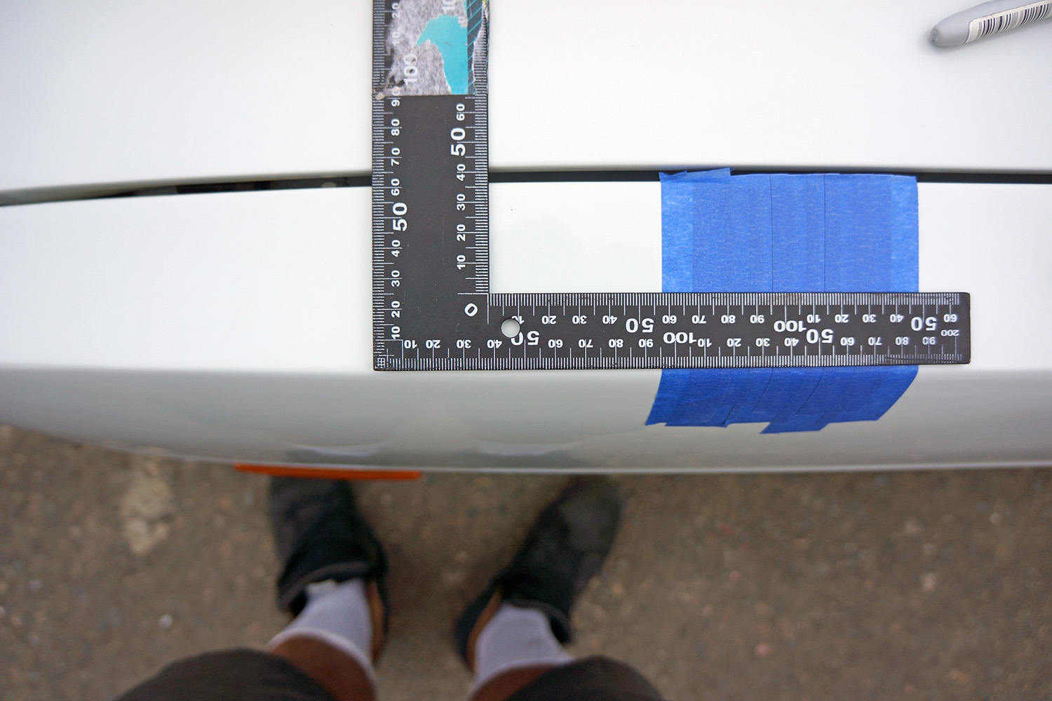

I went with 750mm which is about as far aft as I would go. I had them installed much further forward on a previous car and decided to bring them back a bit.
They are located just outside centre of the guard centreline and they are Datsun 1000 sports option mirrors with a 16mm pin and 5mm dowel.
Happy with the fitment but will look for convex glass as I unknowingly purchased flat.

Hey chris what measurement did you use?

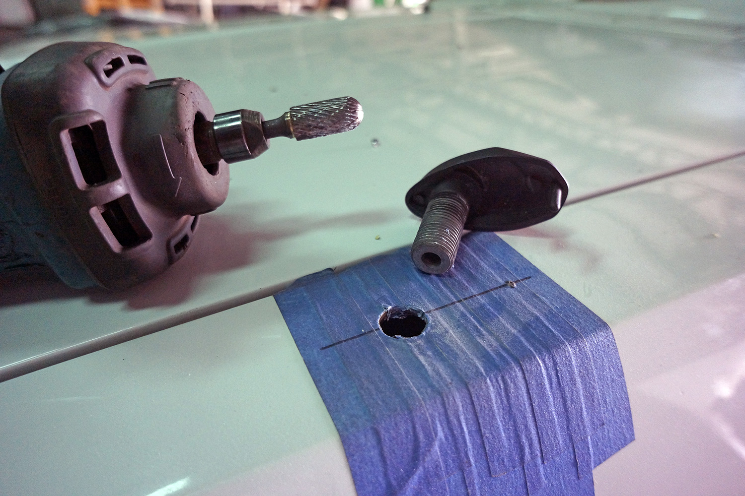

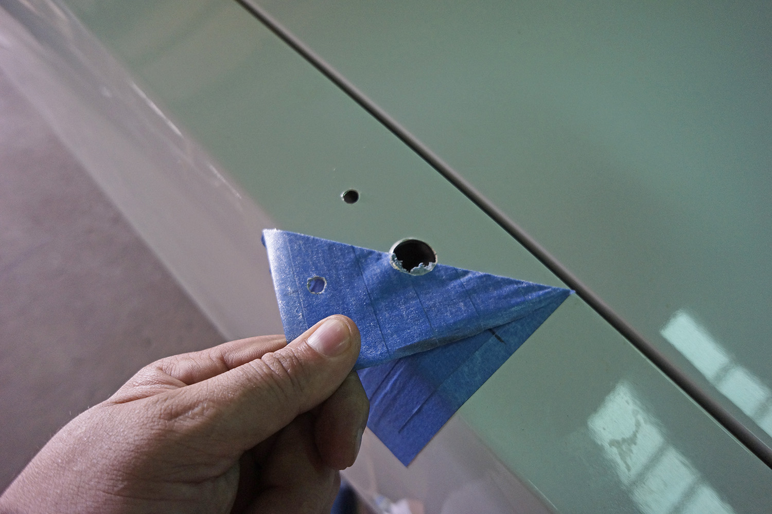

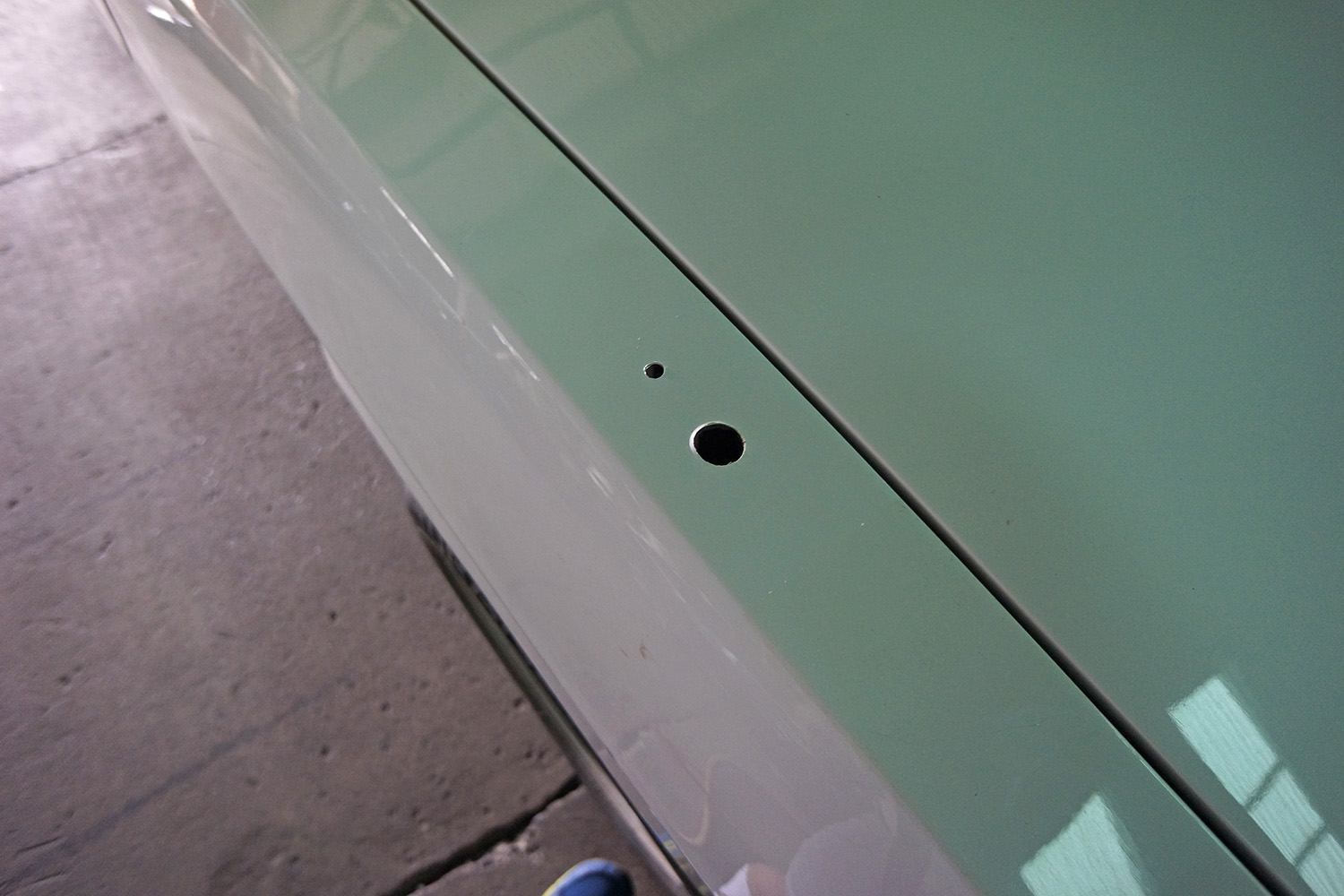

Installing Guard or Fender Mirrors
2007/1/22 23:06
Posts: 6981

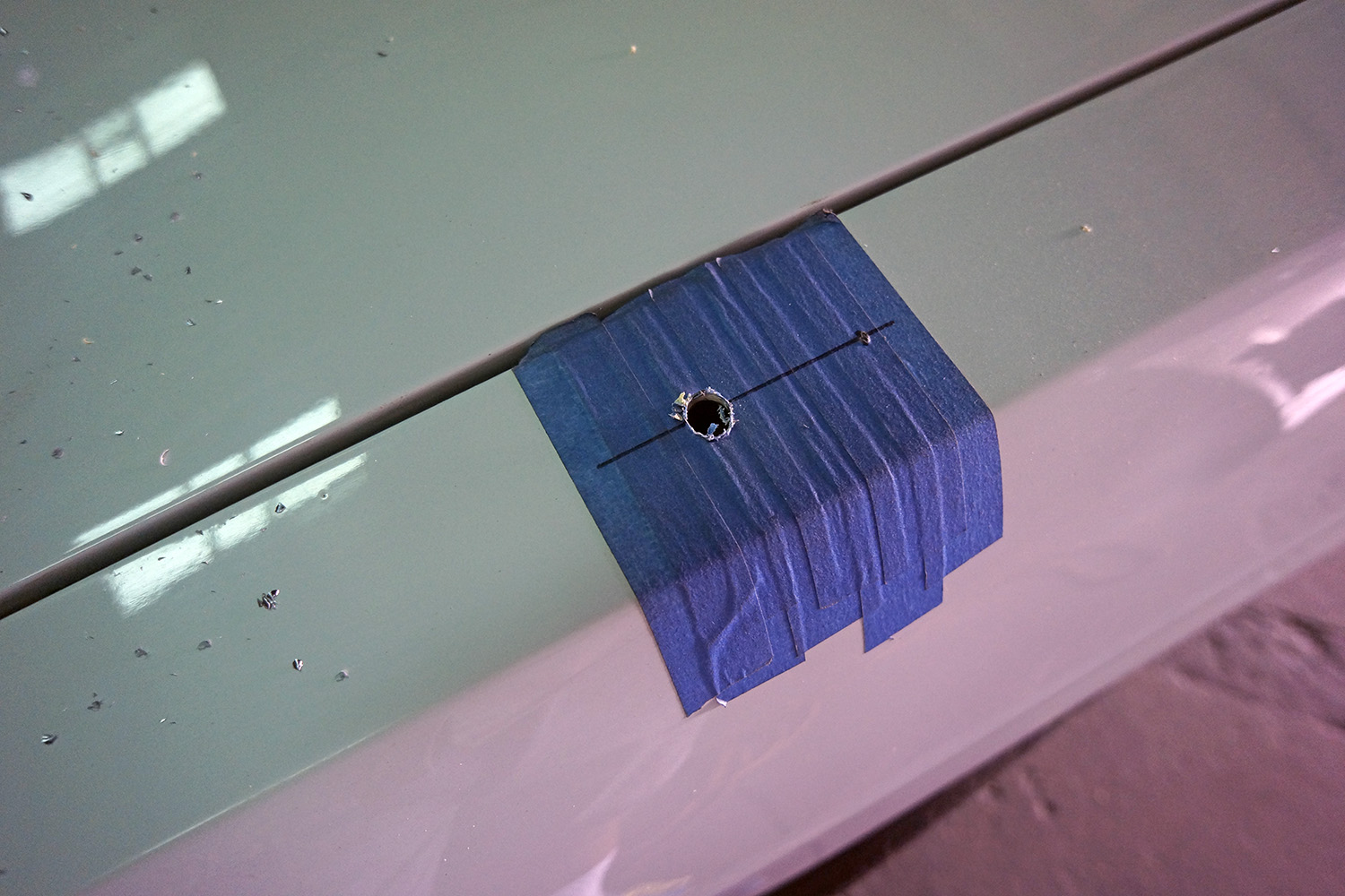

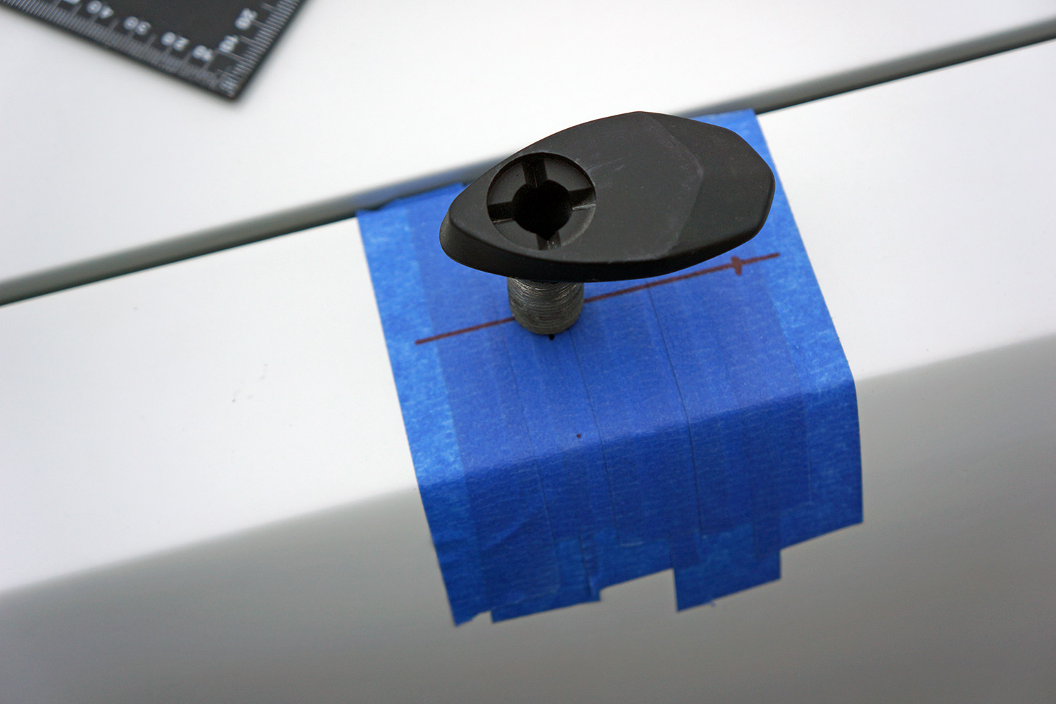

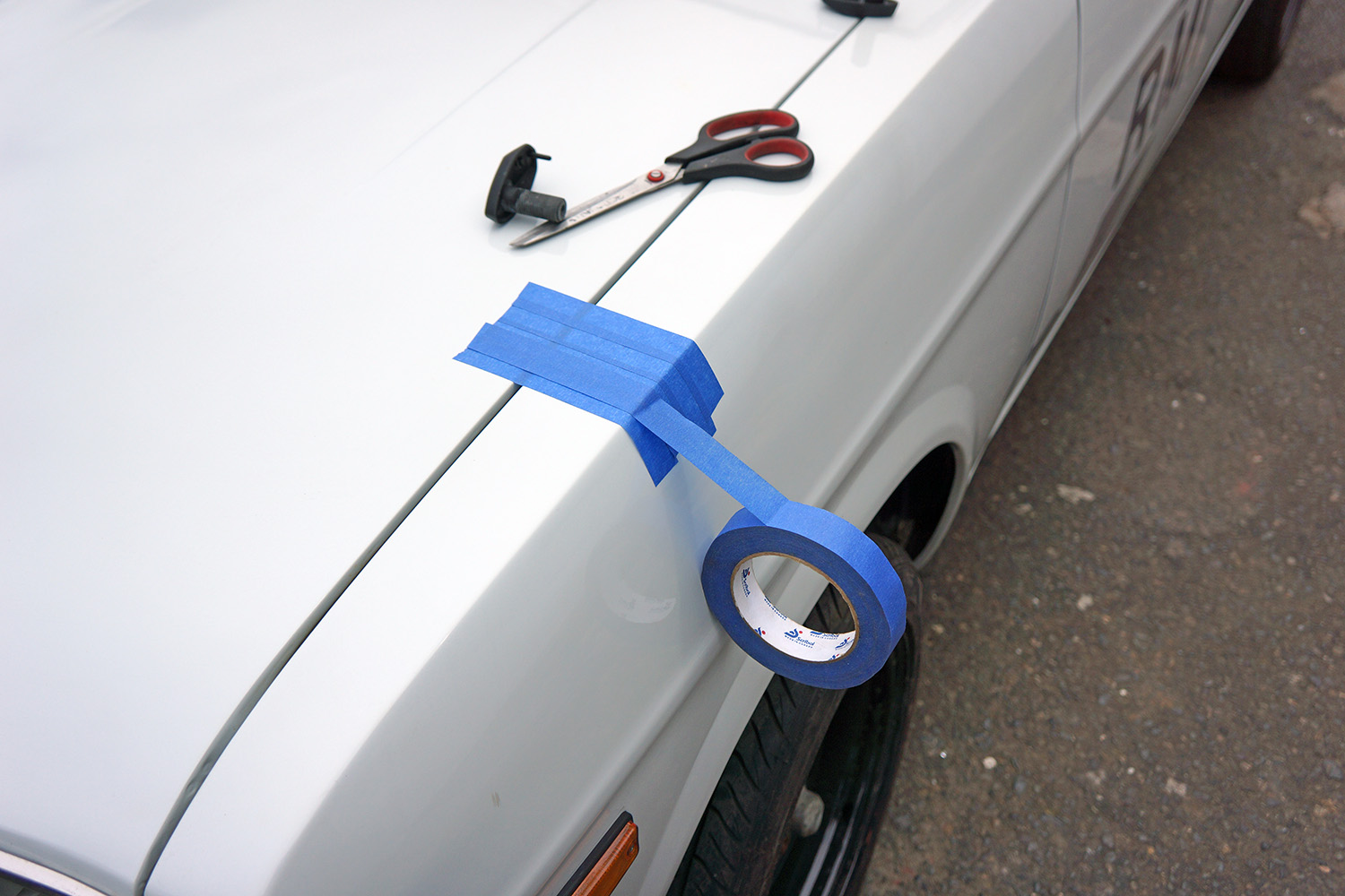

I wasn't so lucky doing this for the first time, so I thought I'd document this install.
Posted on: 2014/12/14 3:18
