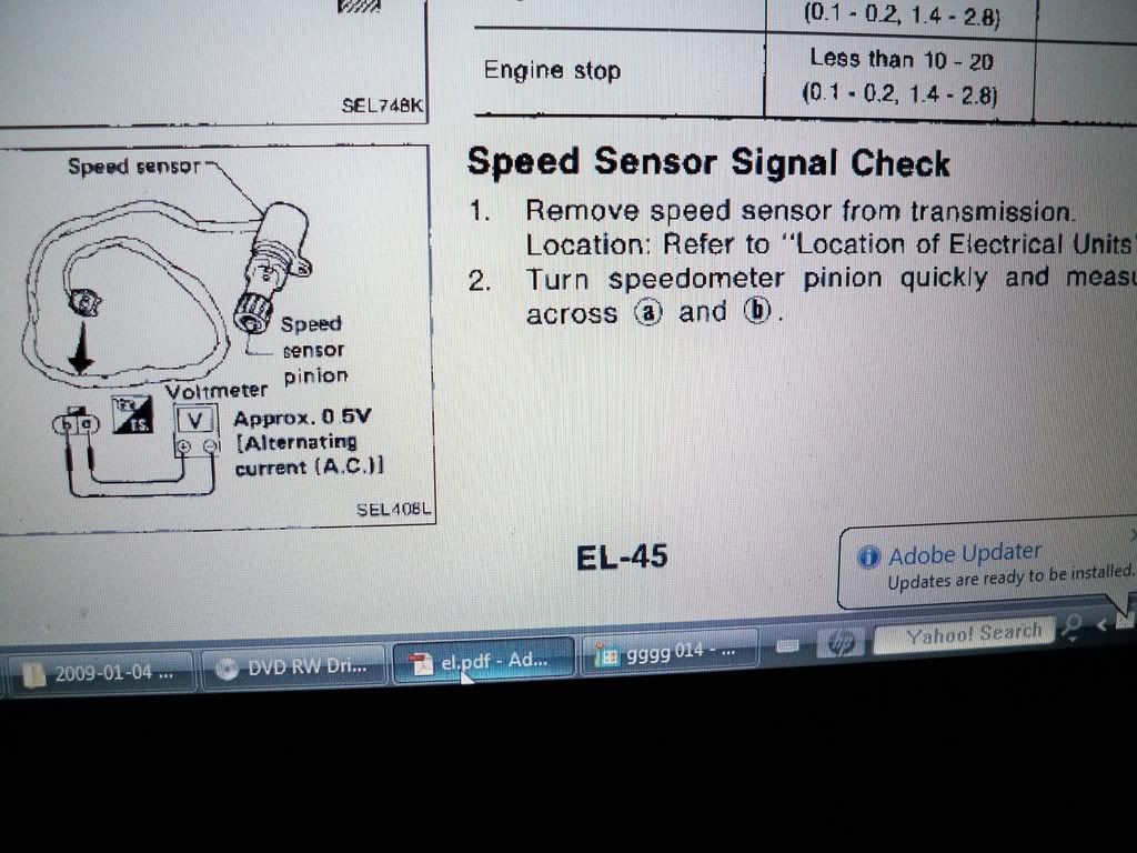

Re: Speed Sensor
Speed Sensor Signal Check
1. Remove speed sensor from transmission.
2. Turn speedometer pinion quickly and measure voltage across the two pins

Speed Sensor
2015/4/11 6:07
Posts: 19
Hello,
Wondering if anyone could assist me. I have a Datsun1200 with CA18DET conversion. The speedo stopped working, but the tacho and other instruments just fine.
From the ECU i am getting 12v on pin 53 which i believe to be the speed sense to the speedo cluster. Im not sure how to troubleshoot it. If anyone has any pointers or has encountered similar issue would be great.
Standard CA18 5 speed manual.
Thanks Rory.
