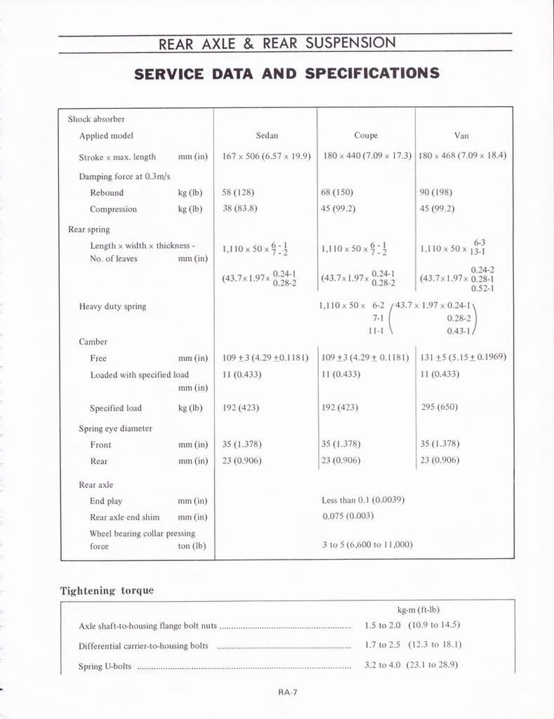

Factory service manual says 440 less 180 mm stroke ( = 260 mm).
Diahatsu Feroza first model uses the N43 also.
From the ARB catalog:
Feroza 300: N43 compressed length 295 mm
Feroza 310: N49 compressed length 271 mm
Posted on: 2015/6/12 2:36

Quick search says
1200 coupe :
459 mm ext
279 mm compressed
180.59 mm travel
Feroza:
448 mm ext
268 mm compressed
180.59 mm travel
Posted on: 2015/6/12 2:23
