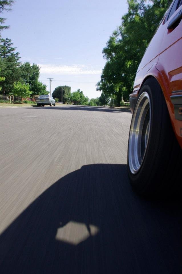

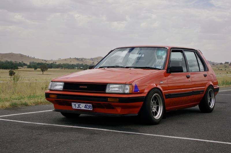

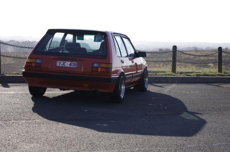

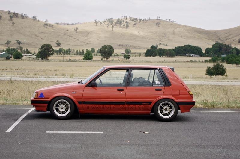

All the negative comments about stretched tyres and voided warranties makes me scared. I do love the look that but I do want it to be safe.
The manufacturer generally only shows one wheel in a particular offset (usually the negative ones because they look better) and it's hard to gauge whether or not I'd be happy with a more positive offset. Been browsing the internet trying to find real photographs of Hayashi wheels and find the specific offset.
Came across this Corolla.
Wheels are Hayashi ST. Fronts are 14 x 6.5 +13 offset and the rear is 14 x 7 +7 offset.
Surprisingly, I actually don't mind the amount of dish.
which got me thinking. If I was to put a 14 x 6.5 rim on the front, I can put a 185 tire on it (within manufacture recommendation?). I now imagine the +13 is an issue with clearance to the strut?
The rear could sport a 14x7 +7 and run a 195 tyre which is also within the manufacturer recommendation?
