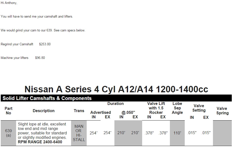

Grinding the cam is done to change the profile. For example, the stock A12 profile is for maximum power at 6000 RPM. If you want a mild profile, they will regrind the cam to 5000 RPM or so. The form attached indicates a longer duration grind causing a slight lope and tuned for 6400 RPM use. If you replace the carburetor with a larger one it can take advantage of it, if you rev the engine higher it should make slightly more HP than the stock cam profile.

just curious dd what your opinion and recommendation is with grinding my cams and lifters on my a12?
i asked a cam shop and i filled out this form for them, this is there recommendation (see attached pic and i have no clue what any of it means lmao!
also i there any downside from grinding my cams?
