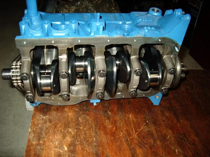

Another Example of a less extreme kinfe edge A15

lemonheads crank is extreme knife edging, having just done the research and seen my brother just knife edge a crank, what lemonhead has done is alot more of lightening than convetional knife edging
i was shown a performance crank for a 350 chev the other day, and the factories version of knife edgin is simply rounding the front edge of the counter weight(front as in the egde that is spinng forwards if that makes sence) so that if it does some how come in contact with oil is glides through it smoother
not really alot to it, just radious all the counter weights on the crank and it will be knife egded(they should really call it spoon edging ), but you cant get too carried away with lightening if you are on a budget as the lighter it is the more expensive it is to balance

wow that looks soooo much lighter I bet it would be heaps more responsive at light throttle touches hey?

Lemonheads knife edged crank.
