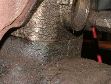

No need to pull the head, unless it was coming off anyway. If the engine number has an A13 prefix, then the block will either be essentially the same as an A12 [1974 & later version] or an A14/15
Personally I would have suggested the larger engines simply because they develop more torque which will handle the heavier body of your car a bit better.
The short stroke engines perform better in the lighter chassis, but should still be acceptable in the Bluebird.
The first pic illustrates the short deck block while the second is of an A15. Hopefully you can see the difference as I foolishly didn't use anything to provide a scale comparison.
