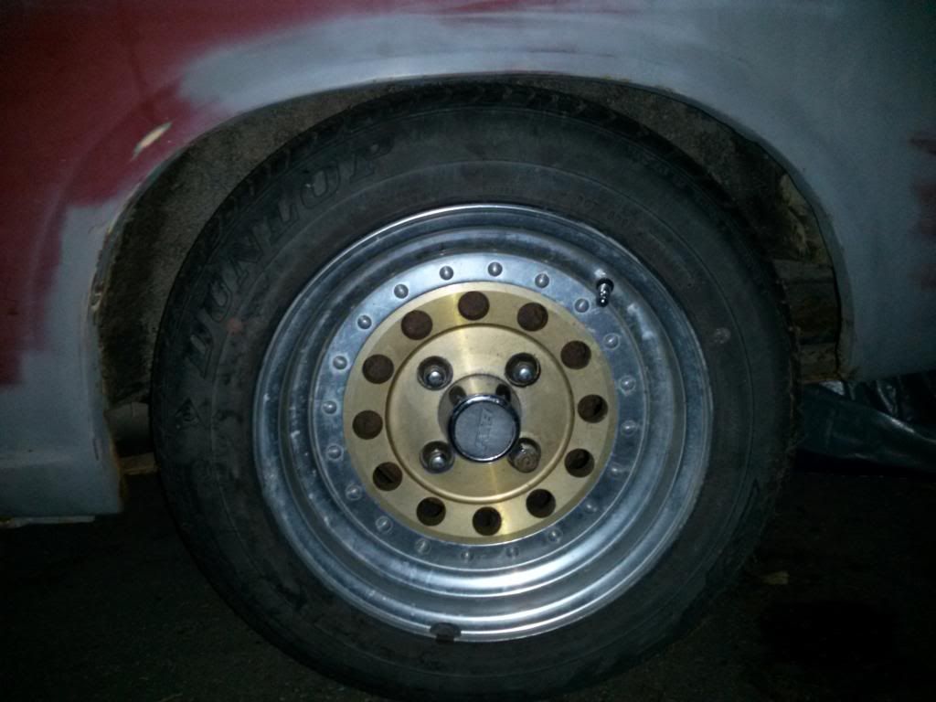

well i cut a bit more off the springs as i was up around 30mm in the front and 0 in the back (spacing from tire to lip). so it looks a little bit better now. i just have to finish putting all the new bushings in and ill put up a pic of the finished height.

well i have three sets of springs (two parts cars) so i figured i'd give it a shot this way and if i don't like it ill switch it back. I measured the space between the front lip and the wheel and i got 30mm in the front and nil in the back so i might have cut a tiny bit out of the front. to bring it down to that 10-20mm that was suggested by littlefreyone.

the front needs to be a little higher than the back, say 10-20mm max, is this a road going car or off road?

i would probably check all of your tyre pressues before doing so, and id measure from the bottom of the guard lip and the lip of your rim.
i cant see why not?

Here is a pic of the current rear end height
If i were to measure the gap between the top of the rear wheel and the bottom of the fender would it be same as the front gap?
