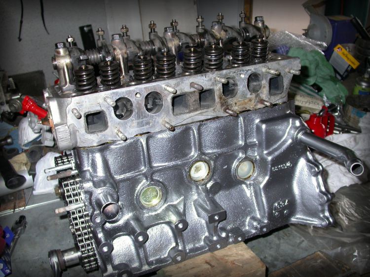

anyone out there who has built a turbo motor... what size valves do you run? my dad is building an a15 to suit a t25 rolla bearing but we are finding head setup info difficult to come by.

I'm running mine Stock as the get born..... though I am tempted to clean out the combustion chambers a bit.... they have some rather nasty sharp edges, and that is bad news for boosting anything approaching a bar.

im not a15 but a12 and ive found the a12 standard size are a good go an clean out those ports it helps alot with flow

I've seen a certain member here hunt down and acquire a A14 head from an N10 pulsar...as he thought it had a larger combustion chamber thus a lower static compression ratio.
I belive it was everyones friend 1200rc
