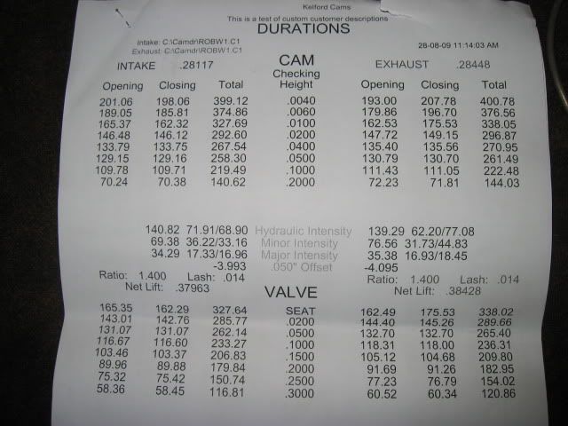

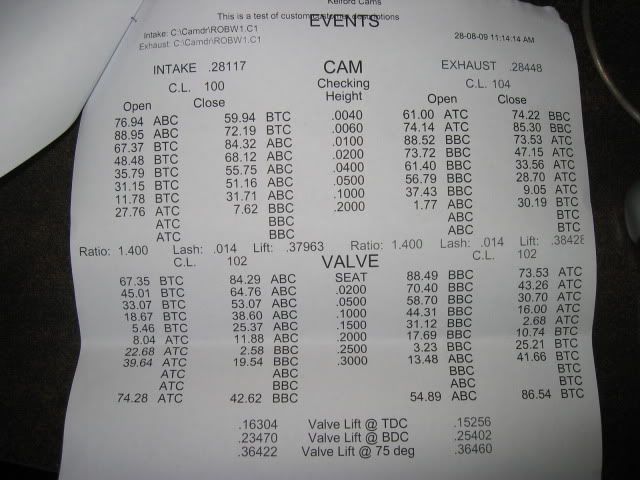

Just wanting to know if anyone has run one and how they go? According to the check its ~9.7mm lift at the valve, and 327degrees duration (thats at the seat).

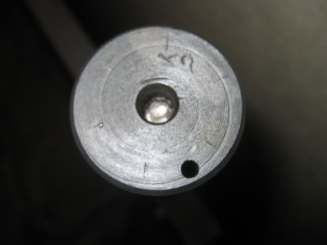

Looks to have Y and either the top of a 2 or a question mark stamped in the end. It was used in a road car running pump gas with a ported GX head that has 6mm skimmed off it (its under 71mm thick). The only thing that confuses me is it has relativity low lift compared to how much duration.
How are most A series cam's duration advertised? Seat or at 0.050" lift etc?

Has the core been turned down between the lobes to allow for the regrinding of the base circle?
Post up the Cam specs just for sh!ts and giggles.

Don't think it has been turned down. Having a look at factory race specs would be awesome Bart.
Markings:
Specs:
