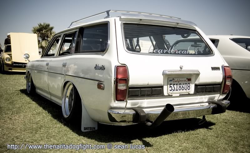

how do they do the rear wheel camber?
2010/4/13 9:22
From Malaysia
Posts: 579
anybody can enlighten me how they do this rear wheel camber? AFAIK, sunny use live axle. do they convert their rear suspension to IRS?

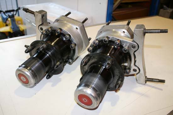

In the case of V8 supercars and many other live axle racecars, to acheive the desired rear camber setting they also employ the use of floating hub assemblies, like these Harrop bad boys.
If budgets could allow, these would be fantastic on our datsuns. [i wish]
I sent my diff housing away to a diff specialist who specialise in camber correction [allignment] of live axle housings utilising laser allignmnet methods. Basicall they straighten the housing to 0 camber and 0 toe and then allign the housing to the customers requirements after that. I managed to get -3/4 degrees camber and 3mm toe in. Anything exceeding those types of numbers and the life expectency of the bearings will be significantly reduced, plus also additional forces would be seen on the alxe splines and side gears in the hemisphere.
