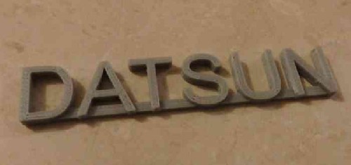

I can laser cut these if you like, you would have to mill between the letters.
I can also 3d print them then have them chromed.
Here's a badge I printed...
jpg  DATSUN EMBLEM 01.jpg (6.67 KB)
15999_556ac5eb8a131.jpg 700X330 px
