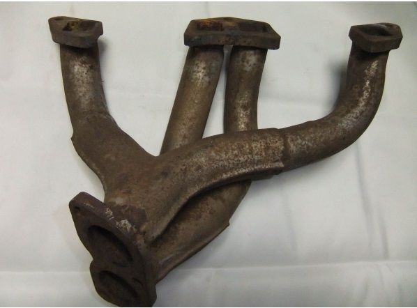

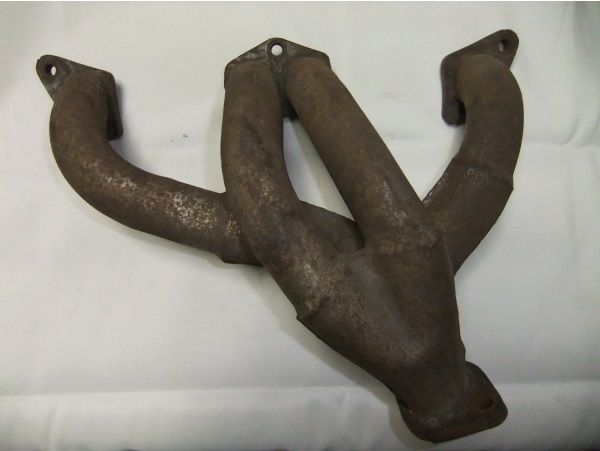

Found one of these for sale in Japan, Looks to be a variation of the cast iron manifold offered by the factory. It can be had for about $500 AU. I bit pricey but certainly not many about that I'm aware of..
Nissan genuine sports parts. Part number 14060-H2310

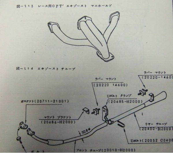

Great photos, never seen them close up. Doubt if they are factory though as they don't show up in the parts catalog but in the "Sports Options" catalog.
Would they work any better than the cast GX manifold which is almost exactly the same shape? These would be lighter, but the GX manifold will be more durable. Maybe these race parts are a larger diameter.
* 14060-H2310 Manifold Exhaust race
* 20010-H2000 Tube Exhaust Front
* 20100-H2000 Tube Exhaust Rear
* 20583-H2000 Clamp
* 20586-H2000 Bracket
* 20710-21001 Gasket Ex. Tube
* 30320-14600 Rubber Mounting
* 20032-C0400 "U" Bolt
