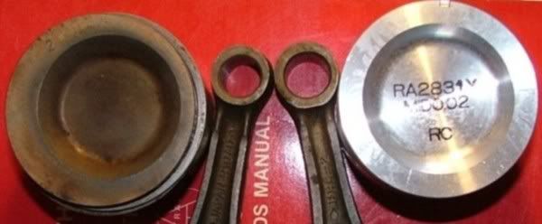

Both of these are A15 pistons. The used one on the left is a factory item while the new one is 'replacement' I will need to machine the crown of the new pistons by about half a mill or so & this will leave me with slightly more compression & a wider bowl preimeter. This will hopefully increase the total squish area of this piston up to about the same as the stock piston.
