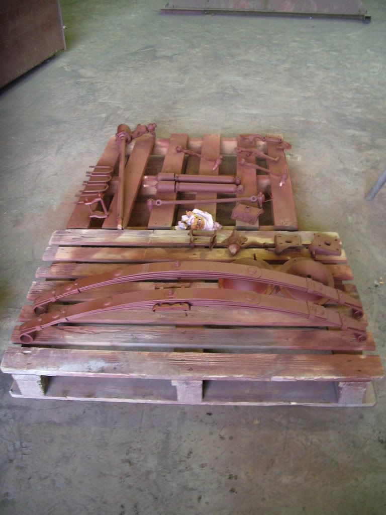

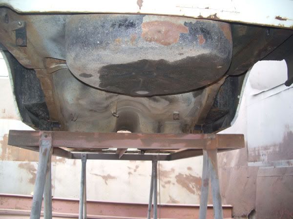

Here are the parts with an IG 269 coat, should have had his photo earlier.

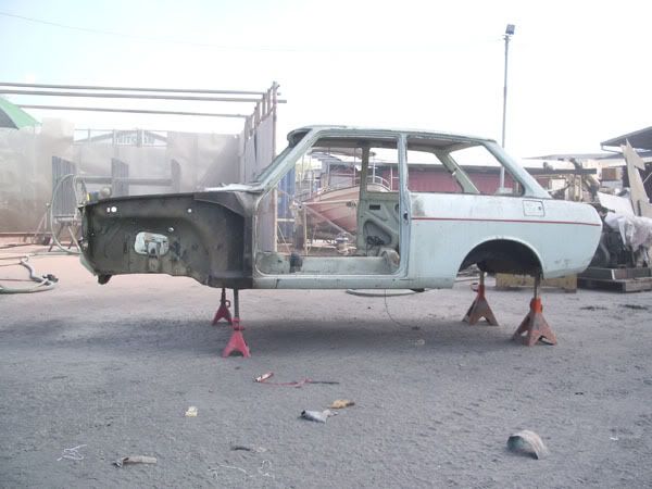

Finally got the shell out in the yard yesterday.
Well it was my first time to blast thin sheet and it all went really well. Blew a few holes in the spare-wheel well but that was all. The underside was in fantastic condition.

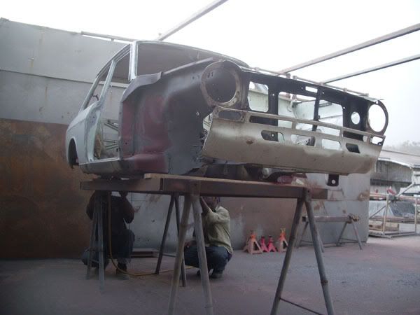

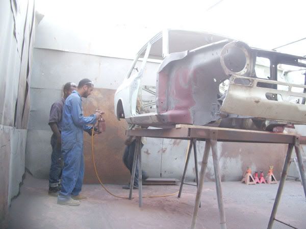

Laying some more primer onto the shell. Using Integard 269 which is a great all-rounder primer. Infinite recoat window and it absolutely loves blasted steel.

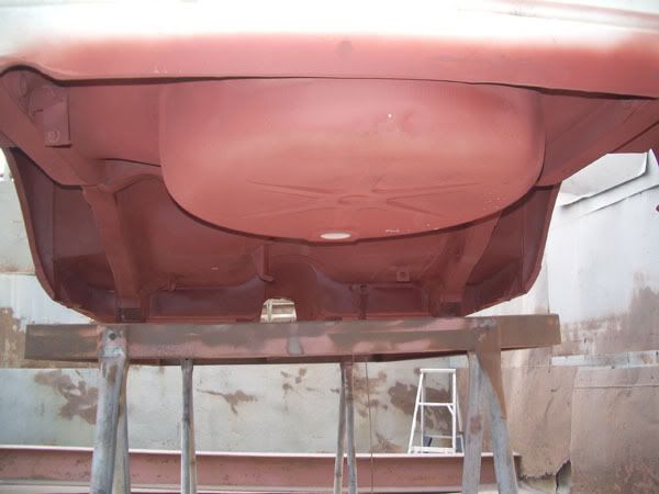

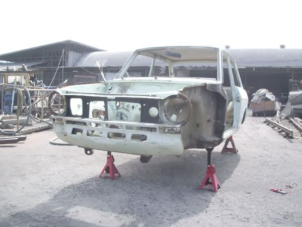

And of course this is what it all looks like after the blast and IG269.
If I had some more time yesterday I would have blasted the engine bay. It started to rain mud (ash in the rain) though so I had to finish up.
A tip for those who are considering blasting: we use blast material called Garnett, it
