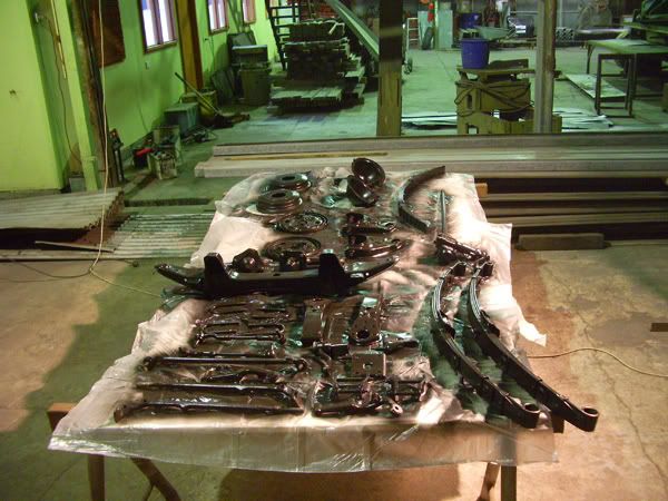

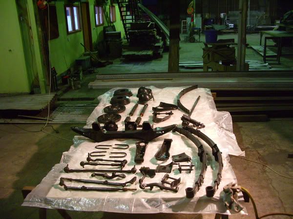

I put the third and final coat onto the suspension parts last night. Using the same old IL688. I was going to clearcoat but I've hit the limit on my budget and I have to spare the clear for the rest of the car. Tonight I intend to install all of the front components including steering column. I also plan to put a clearcoat down on the engine bay.
688 is pretty glossy anyway and it leaves a very nice finish.
So one coat of intergard 269 to hold the blasted state.
One coat of High Solids Interprime 198.
Two thin coats of 688.
And one last generous coat of 688 to pull the shine and lay the thickness.
Before
After (I'll pull them of the mat tonight so I can get some decent shots of the work quality. There was some minor dripping/pooling on the front brake back plates but that was all)

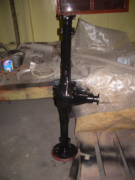

I also put a light coat down on the diff. Final coats tonight, the end that isn't painted is stuffed so it'll be coming off soon.
This was also sand blasted by the way. No photographic proof so you'll have to believe me.
