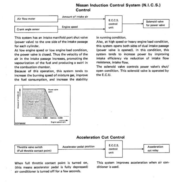

theres nothing wrong with throttle response and drivability
how much do you gain by ripping them out?
no one seems to be able to give an accurate answer
mine are removed and welded and i'm regretting it now. should have tested first.
this from NA pulsar shop manual
starts opening at 3800 fully open at 4000
chris try changing the switch on rpm to 3800 and see what its like
