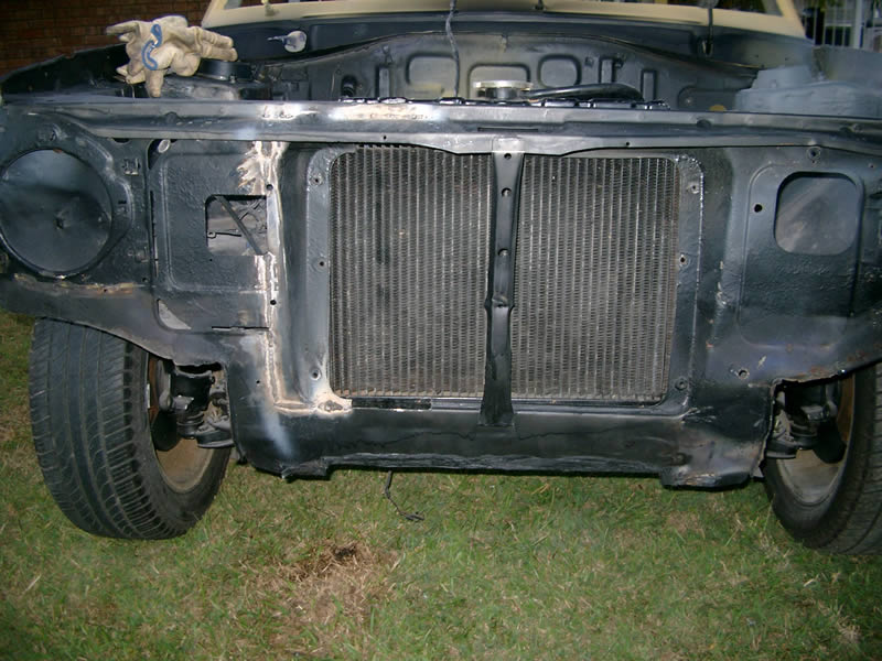

you can get gemini ones for about $40 or $150 reco. most n13 ones in good nick are $150 to 300.
Gemini one fits with just some longer hose on the top tank(hyundai lantra i think) and a little bt of threaded rod throught the front radiator panel to the mounts on the gemi radiator. then with some nuts and washeres to space it out.
N13 pulsar is similar to s13 silvia radiator in size, fillls all space between chasis rails, need more hose on top tank to the engine. also you need the top rad mounts onto the rad support panel and also 2 gromets on the under neath of rad support rail to hold it in place. nice thin core and good cooling. also need radiator recovery bottle.
