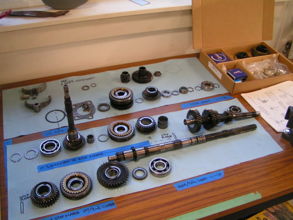

secondly, get a digital camera & take lots of pic's, thirdly dismantle in a seriously orderly fashion, this is what I did...

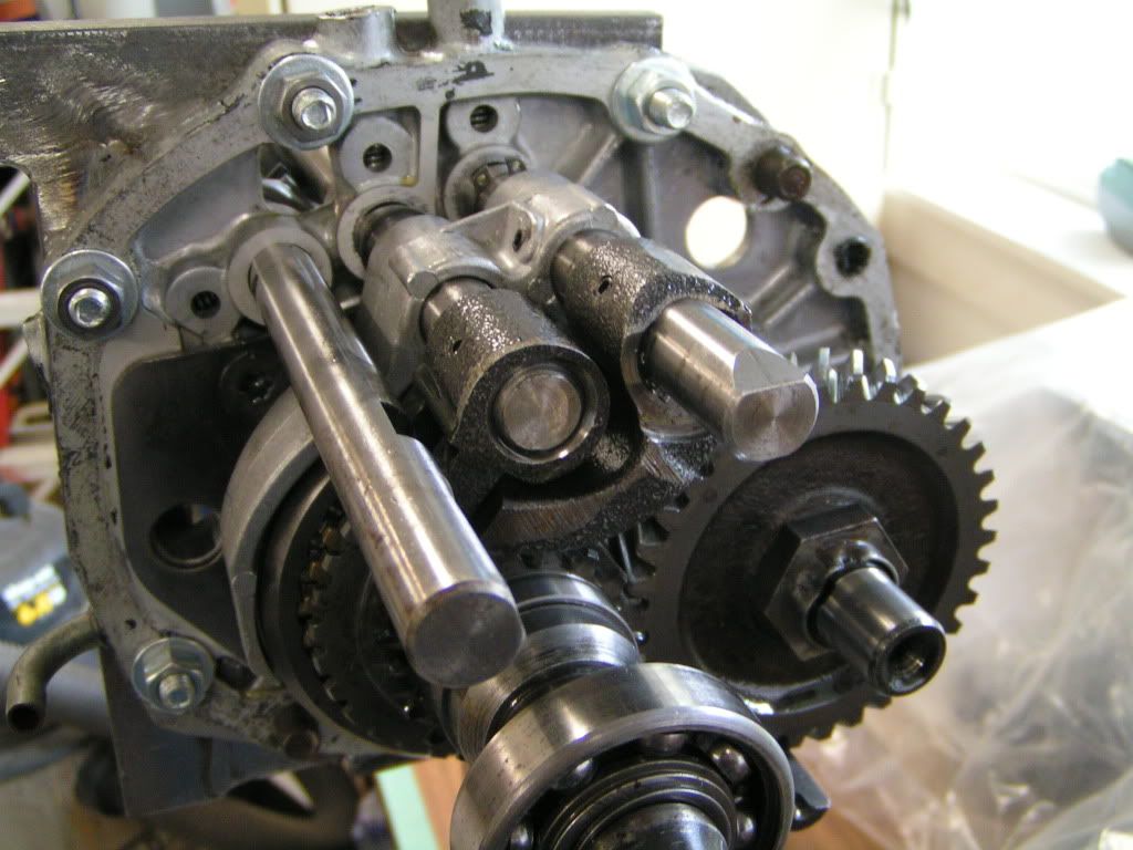

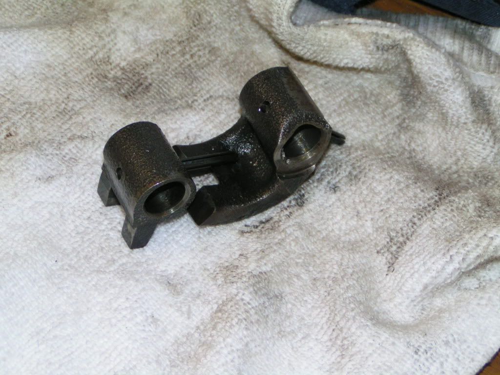

these are the internal forks that the shifter rod has to slot into, the trick I seem to remember is the internal ones need to be aligned perfectly for the shift rod to fall into the slot when installing the tail housing
print out the manual & be systematic otherwise there's a 99% chance you'll f*** it up!
