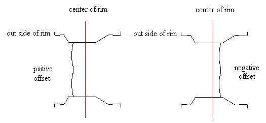

no theres, positive offset (+ or P) and negative offset (- or N), for example +20 means the hub mounting face sits 20mm outside from the centerline of the rim and -20 sit's inside 20mm from the center line of the rim.
my crappy ms paint pic:
sorry for the crappy write up, but i just lost the massive post i first intended..
