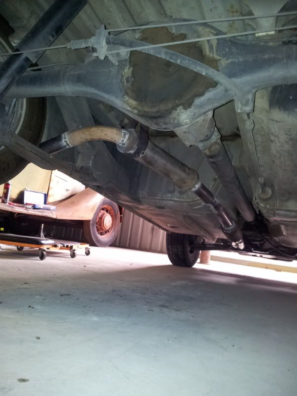

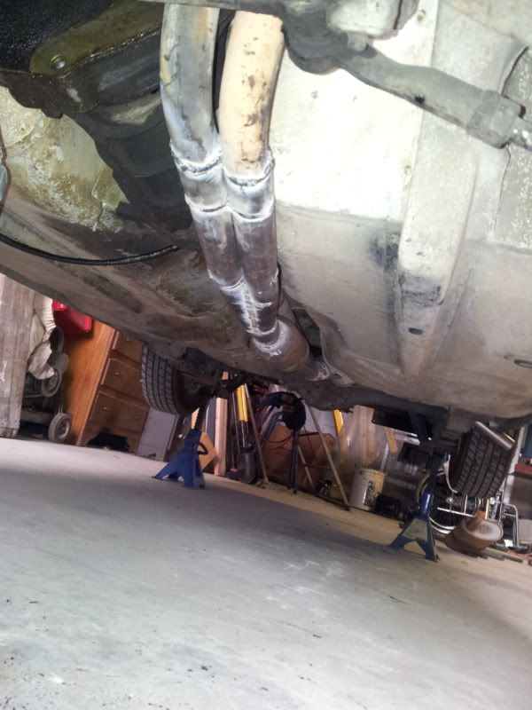

wow haven't updated this in a while. Oot now has extractors into two 1.5 inch then a straight through cat and 2 inch to a small muffler that exits just in front of passenger rear wheel.
Sounded a little rough and didn't have enough back pressure so lost a tiny bit of power. So made a silencer from stock exhaust pipe. Still a bit loud but sounds killer on deceleration and got power back.
