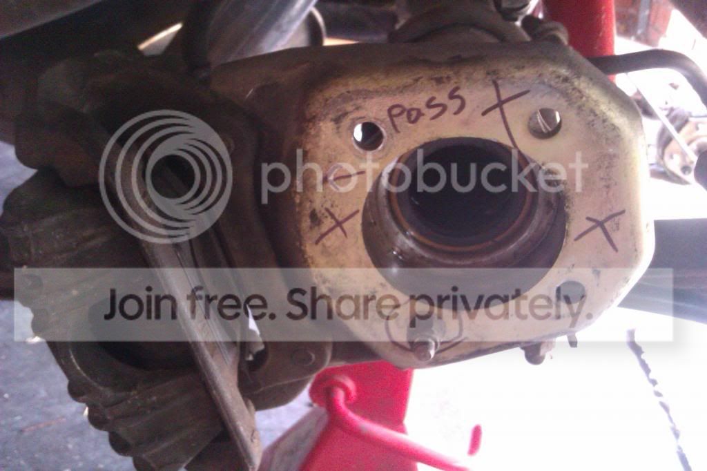

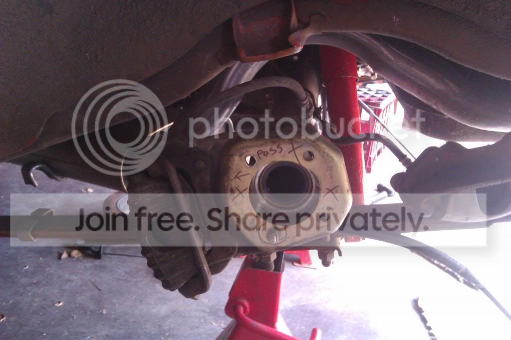

going skyline brakes, this was the mock up, forward and down looks best to me
you can see where the bluey setup was hitting - multiple places, i think coupes have the least clearance to chassis and such
i have since drilled the plates accurately and organised to have some bearing retainers welded in
we made a jig for drilling the backing plates if anyone else wants theirs drilled super accurate
