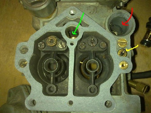

Hi Guys
I have bought a new carb rebuilt kit for this carburetor and
installed these things
Power Valve
Main Jets
Floater Valve
Accelerator Pump Piston and Check Ball
Air fuel Mixture Needle
Another slow jet i guess
and i fixed the carburetor and started the car it did not start ,(First Bad Experience after a carburetor rebuilt)
Could not start it anyway checked the floater glass it was up to the correct level and checked the ignition on plugs those were ok,then finaly removed it back.
and found out
Power valve was not tighten properly to the edge
and also there were 2 small check balls on the rebuilt kit and i installed them to Red and Yellow Arrows and later found that out of 2 check balls that were there on the car earlier one was little bigger than one,
Where should i install the Big Check Ball is it to the Accelerator pump chamber(Yellow) or to REd Chamber ?
are those mistakes could be the reason for it to not starting ?
Please i need your guys assist
thanks
regards
sumith
