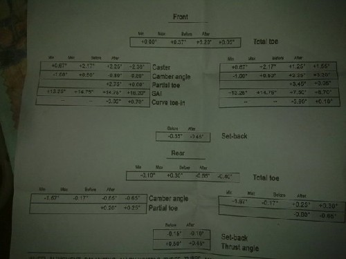

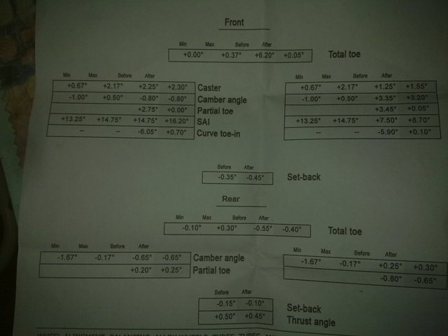

Hi DD
I interchanged the front and rear tyres then it became verse
i checked each and every tyre for bent or crucked but none of them had such an issue , so what strange problem could this have,what else to be checked further ?
It was running perfectly earlier i could reach 100 KMPH without any wobble or shaking earlier,
then suddenly it came. so i replaced the tie rod ends because they were not good too.
Could this be These Tyre Combination changes
Earlier
Rear-165X13 8PR
Front-155X12 6PR
Now
Rear -165X13 8PR
Front-155X80X13 6PR
if i interchanged this combination it became verse
Look at my Wheel Alignment Report do you see any issue there ?
thanks
regards
sumith
