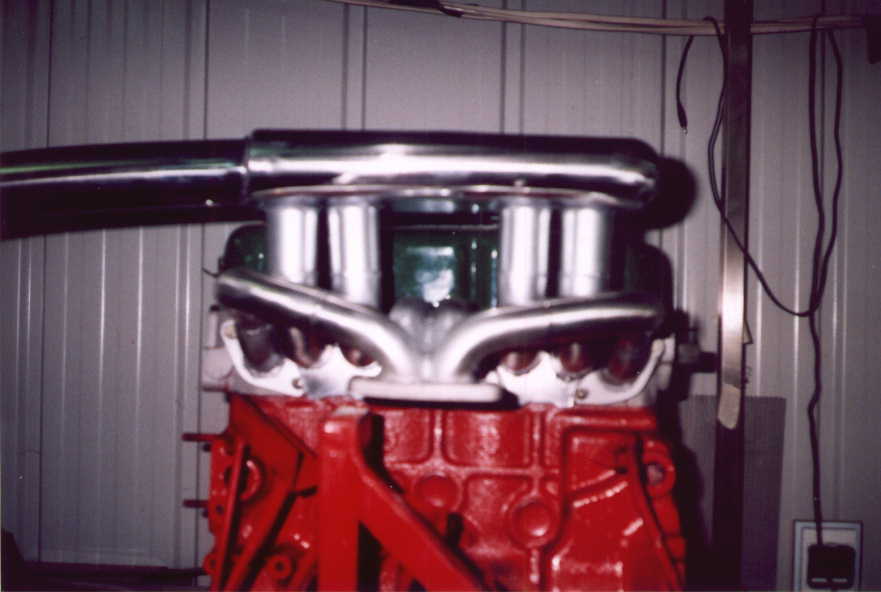

so let's say someone is making a manifold for a turbo.
maybe like this one:
since the 2 pipes for the center 2 cylinders are going to be shorter, would it make sense to make those 2 pipes a larger diameter than the longer ones to try to compensate for the difference in length?
t25 a good size for an a15?

A mate and i have just finished just finished doing something similar to an a14... the length of the runners on the exhaust manifold will be fine .if they were equal it would be better but i think the difference would be tiny.. a t25 is perfect , we had a t3 something on the a14 worked well after 4000rpm bit laggy before though..

well then. I'm going to start collecting the raw materials. I've found all the stuff except the manifold flange for the engine side.
So equal length would be ideal, but it's not the end of the world.
I'd like a turbo that takes advantage of the lowend torque and lower redline of the A15 so if the turbo peaked at 7000 rpm that's fine i shift at 6250
