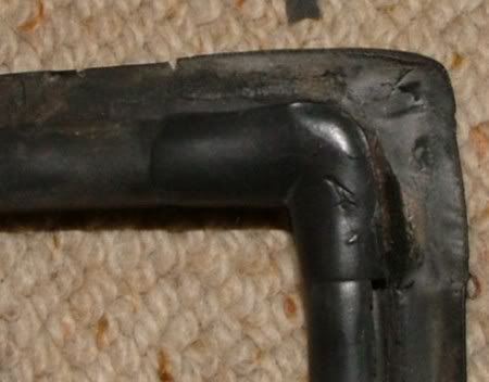

The problem with them is that despite the fact that they have four square corners on the outside, they have only two square ones on the inside.
This is a top corner. It is the same as a windscreen corner & has a square outer
flange as well as a square inner seal.

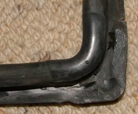

This is the lower outer of the rubber & it has a square flange.
The inner seal has a round corner & this corner piece is not manufactured by any of the replacement rubber companies. It's this part that is preventing KB10 owners from being able to buy a new back window rubber. The other parts are the same as the windscreen rubber, so a new Coupe screen seal was cut up to make a new back window one.
Fortunately the screen rubber is longer, so material was cut from the offcut piece

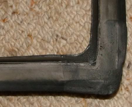

to fabricate a new square flange in the lower corner.
It might look less than perfect in this close-up shot, but most will be covered
with the trim.

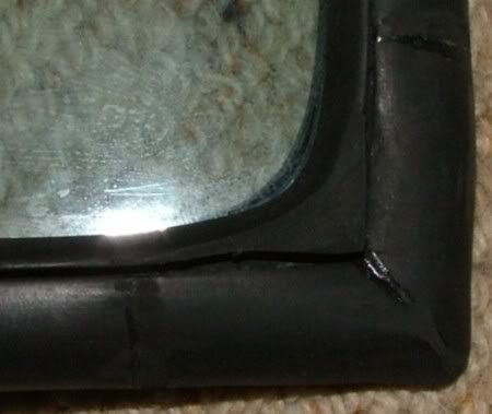

This is the inside with a nice round corner. The flange was reinforced here where two pieces join.
There were a couple of trial runs with offcut pieces & it took a while to do, but I have a new seal. We'll see how good it is when we try to fit it.
