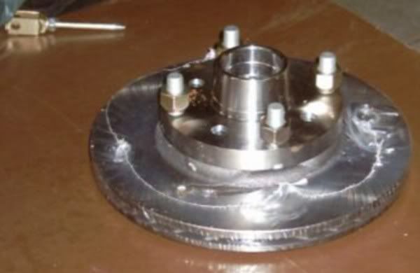

I bought one of these kits a while back & was amazed at the quality of the specially made parts. The laser cut caliper mounting bracket is superb & the finish of the CNC machined hub needs to be seen to be appreciated.
Sadly, the photo doesn't do it justice but the hub with new rotor attached will give some idea. Remember the rotor is covered in shrink wrap, so it looks a bit funny in the picture.
If you have a B10 that needs discs & are unable to engineer them for yourself, then this kit is just the ticket.
Thanks Neil for simply creating the kit. I love it.
