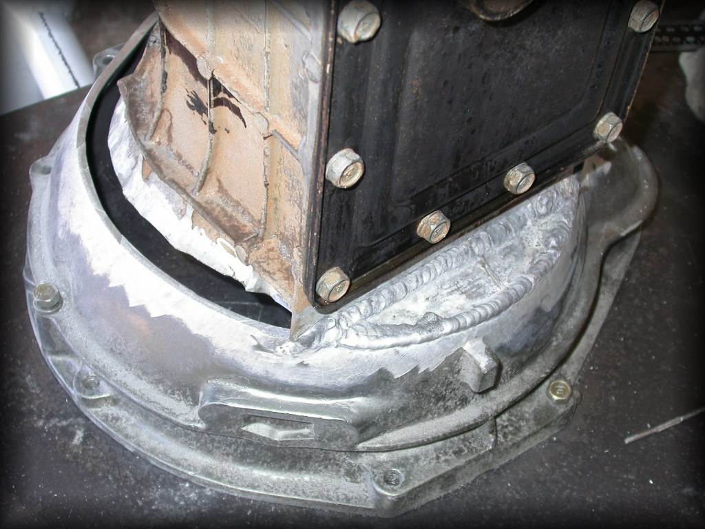

Basically I'm gonna be getting into both with a grinder, then tig-weld the Nissan box's B-housing onto the k40's body, and try to do this with it's all lined up straight...
Then I'll have to hope the clutch still works...

damn this is easier than I thought, or maybe should I keep my mouth shut, I'm not done yet :)

Indeed I am, but as average as these boxes might be, this one is actually stronger in every way I can detect, compared to the Nissan box. Both the input and output shafts are one spline thicker , the one thing I do like is the gear-shift that can be bolted off, to add oil, So I can even do it in the rain, and not get wet. So far all is going to plan, the clutch cable almost did not clear the starter, but it did, so all's well there, I just took my clutch plate in to get the center changed to the right size, While I was at it, they are going to lighten the flywheel as well....
SHould be fun....

nope.... you are more than correct.... snapped this one like a twig.... OI
now have to do it all over again with a T50....
