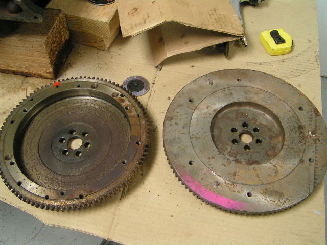

I have two flywheels that I removed from 2 different A-series engines. One from an A12 & one from an A14. The A12 looks lightened substantially, its diameter is 9 7/8" , theres approximately a 3/4" deep recess from the ring gear surface to the clutch surface. The A14 one is 10 3/4" diameter & flush across the surface. It looks like comparing the two that the A12 one has been milled down quite a bit.
I took pictures & tried to upload but I cant seem to get it to work right. I resized them & tried uploading but still no go. Ideas anyone?
what are the standard diameters of flywheels for these motors ? I thought they were the same diameter through the A series line, am I wrong?
Thanks, Evan

OK, I posted some pic's to the site. they are pic #'s 465 thru 468.
If somebody can tell me how to get them into this post that would be great.

I thought they were all the same diameter. Could one be from the B-210 with 5-speed? It used a larger transmission & clutch.

The one where the clutch sits inside the flywheel is from a front-wheel-drive car, probably a 76-77 Datsun F-10 (E10) or a 78-82 Datsun 310 (N10)

I had an F10 once, I have no idea what the flywheel looked like though. Would it have been a smaller diameter?
Would the previous guy have used it on this motor for weigh savings or some such? My plan had been to bench run this motor & I needed to put a started on it so I pulled the flywheel for an A14 I had to get the cover/protector plate to swap onto the A12 & then took this flywheel off the A12 & I found the differences then.
It even looked like someone had previously milled the bolt heads down, they had a very shallow head on them, approx. 3/16" high.

Neither of them look much like A series to me
The one on the left the recessed one... NFI
Never seen one like that before on an A
The one on the right.... strange that it has a step on it
Toyota do that
20 thou step
More clamping for no extra money
My race flywheel is like that though
Usually A series are flat across the face

I have a third A12 motor in storage that I'll pull the flywheel & compare that to the others. the one with the recess is at least 1/2 the weight of the one off the A14, thats what made me think its been milled down.
They both definitely came off A series motors, it'd be nice to know diameters of stock flywheels for A12's & 14's if anybody knows.
What motor is standard for an F10?
Thanks, Evan
