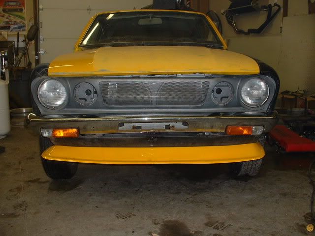

Woohoo! I like that "Sunny Yellow".

How'd you attach the spoiler to the valance? I picked up one that's supposedly for the 1200 that's similar to yours, (there's one that looks just like it on e-bay right now).
I was just trying to figure out the best attachment.
thanks, Evan

Drilled holes in the F/G and used sheetmetal screws through the valance.

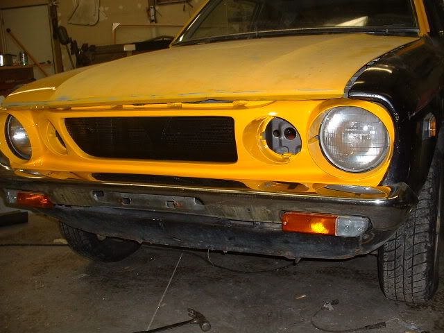

That is a pretty bright color, it should pop well in the sun. What are you painting it with, single stage or a b/c ?

It is a single stage. Made by AKZO NOBEL called Grip Gard.
Sikkens equivilent to their discontinued Autocryl line.
Just had a different label and less expensive made for the sign industry.
I have been using it for nearly 20 yrs and it has now become but nonexistent. They are discontinuing this line also.
Painted my Jeep with it about 18 yrs ago and it still shines up nice.

Looking good mate, is this the car the GX motors going in? Love the spoiler, will be getting one in the near future for the racecar, if the bloke will post to Australia that is.

Thanks for the compliment. Yes it's the car its going in. its actually in it now
Is that the guy in Oregon? that is where I got this one(spoiler) from.
