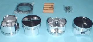

I wanted 77mm flat top pistons & they were made for the 1200/A12 with the small pin, so my A12A rods would be redundant. H beam rods were readily available, but the pistons weren't, so I switched to 78mm pistons from the A14. These have the larger pin size & since my block was made with a 76mm bore, it's not stretching it too far.
Well since I was getting pistons, I might as well get rods, but the only large pin rods were the longer A14/15 ones, so I had to have a set of rods made to order. These are essentially A12 rods with the larger pin size, so they are custom A12A & A13 rods.

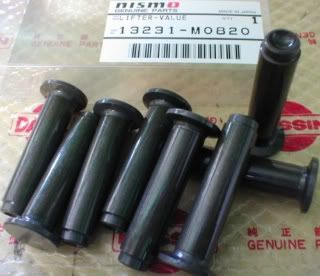

And while you're at it, says Mike, how are you off for tappets? What about some of those nice Nismo lightweight hollow ones.
[In for a penny, in for a pound] Yeah yeah, might as well. Next e-mail,"Tappets are NLA" Oh well, never mind, I have some new ones I can machine to lighten so it's all good.
Next thing, "Hey Chris, I found a set, ya want em?" [In for a penny etc. etc.]
So now we have tappets. [but no cam yet]
