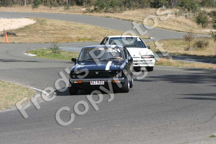

From a grotty looking brown $70 car to a road registerd race car in 6 months my sons coupe went well on its first outing,need to do a couple of small changes to rear suspension,but very happy.Open in new window

looks good, any other photos? i remember having a quick look at the thread, but would be good to see some more in action

I will try and get some more shots in the next couple of race meetings.GREG.

it does look really good! nice work

Looks tough, love the colour and racing strips.
Sits nice and low aswell.

whats the specs? what motor you running?

Go the dato! It looks great. Just out of interest what pressures do you run in the avons?

Steve..Nothing to special,1280cc,flat tops,A14 crank,oval port head,10.5:1 ported,32/36 weber,extractors warm cam(Watson)60 series box 200B front end, and soon to have a sunny rear end
The car still gives 35mph and still drives on the road ok(sons daily drive).GREG
