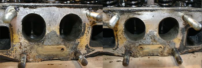

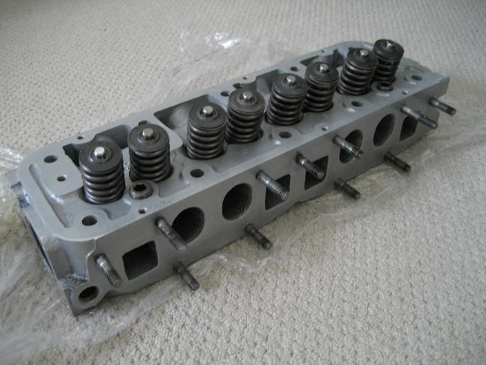

hi i am trying to figure out what head i have i know it is a oval head .. the thing i am trying to find out is it a big oval head port or a small oval head port they both look the same to me... and im trying to put some side draughts on by today so please help!
here is my manifold:
http://i143.photobucket.com/albums/r1 ... AZIE_LOCZ/0427090909a.jpg
http://i143.photobucket.com/albums/r1 ... AZIE_LOCZ/0427090909b.jpg
http://i143.photobucket.com/albums/r160/KRAZIE_LOCZ/0427090911.jpg

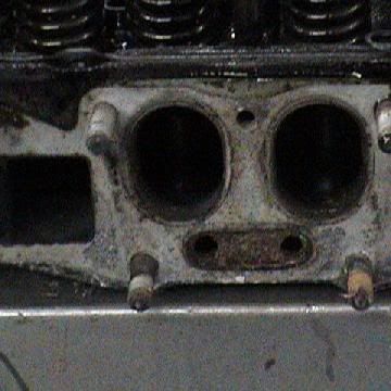

* Small oval (28 mm x 30 mm). The 1974 A13 has this design.
* Small oval with swirl obstruction. These are good for emissions and fuel economy
http://i143.photobucket.com/albums/r160/KRAZIE_LOCZ/4444.jpg

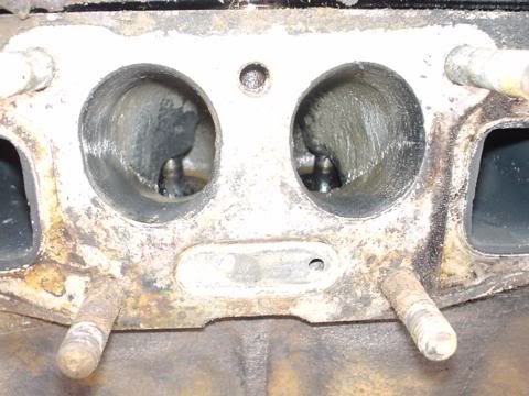

* Large oval (28 mm x 34 mm). These std A14/A15 ports are best for high-RPM operation, or for the bigger engines
http://i143.photobucket.com/albums/r160/KRAZIE_LOCZ/14888.jpg
http://i143.photobucket.com/albums/r160/KRAZIE_LOCZ/14886.jpg

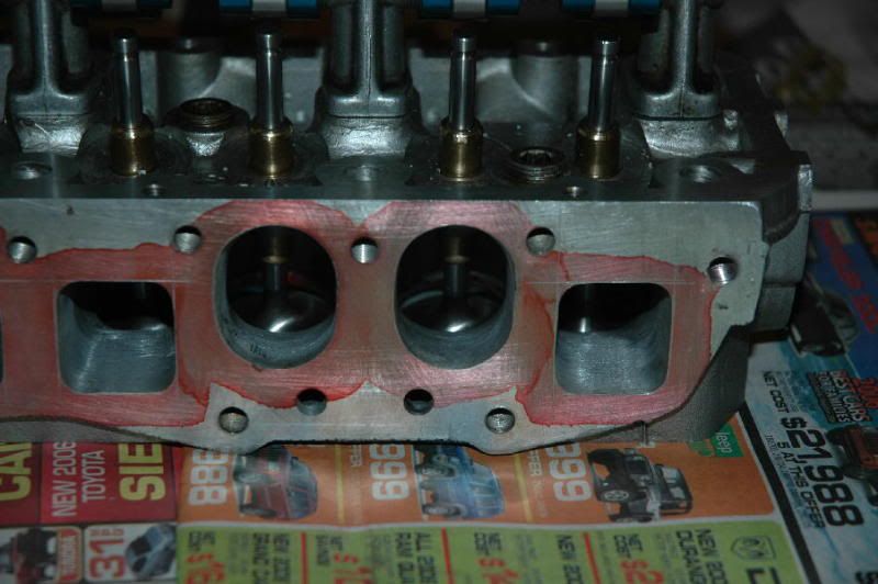

* GX oval (30 mm x 36 mm). From A12GX and A12T engines.
http://i143.photobucket.com/albums/r160/KRAZIE_LOCZ/9028.jpg
http://i143.photobucket.com/albums/r160/KRAZIE_LOCZ/12131.jpg
NOTE: the top of the port comes up as high as the top of the top bolt holes (port comes up past the bolt hole centerline)

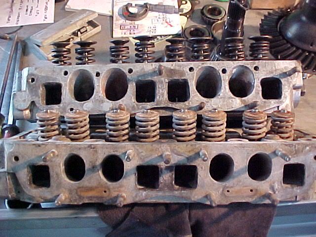

GX Oval vs. A14 Oval Comparo :
http://i143.photobucket.com/albums/r160/KRAZIE_LOCZ/5215.jpg

It looks like a standard late-model A14 head. Standard oval port.
Measure your ports (width and height) and you tell us!

or pop the rocker cover off and take a pic of head from above and the side.
Posted on: 2009/4/28 6:43
Re: What head do i have ???
Yes, if it says H72 or H89 on the top of the head (remove valve cover to see) then you'll know for sure. It's just six screws and the gasket can usually be reused.

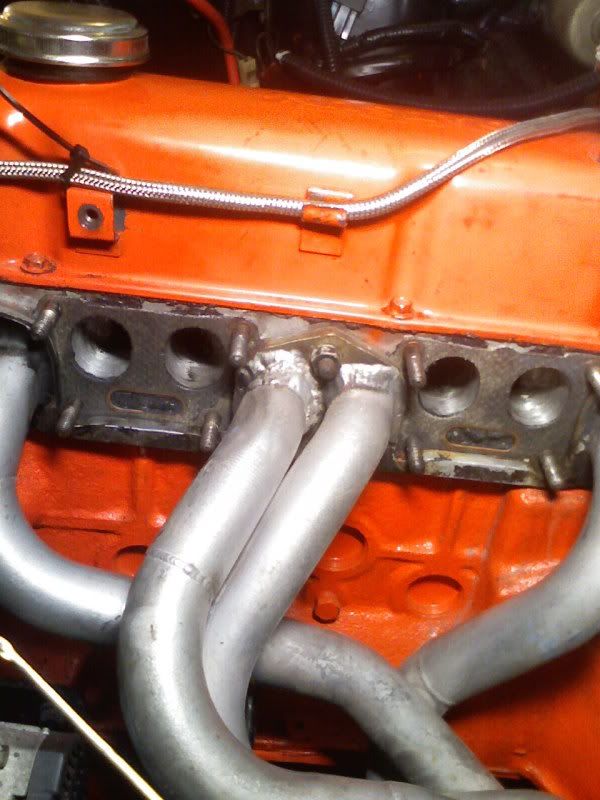

alright thanks do you guys know were i could get a manifold for some side drafts...???? the same head type that i have ??? i just bought some 40 dcoe's brand new ....

Any A14 manifold will work. If it doesn't cover the water holes in the head, then plug the holes. That's what everybody does.
You can buy a brand new manifold for B-Projects via mail order. They are perhaps (?)$260. Send email and he'll write back with a price and shipping costs.
